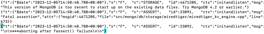

I found out late that I had to upgrade from 4.0 to 4.2 :frowning:
After the update, of course, there was an error, and mongod does not run. (When I restart, failed appears)
So I’m going to install 4.0 again.

The upgrade steps are well documented. The supported upgrade method is stepwise through each major version.
For you, as of today, that will be 4.0.28 → 4.2.24 → 4.4.26 → 5.0.23 → 6.0.12
You should ensure the current version 4.0.28 shut down successfully before upgrading to 4.2

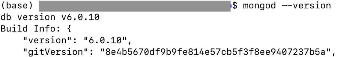

I want to follow the upgrade instructions for 4.2 but I can’t start mongod. So, i can’t use mongo shell.
Now, my mongod version is 6.0.
The previous work I did is as follows.
  1. After installing the public gpg key of version 6, install the list file
  2. Delete list file of version 4
rm /etc/apt/sources.list.d/mongodb-org-4.0.list
  1. Install version 6
sudo apt-get install -y mongodb-org=6.0.10 mongodb-org-database=6.0.10 mongodb-org-server=6.0.10 mongodb-org-mongos=6.0.10 mongodb-org-tools=6.0.10
  1. Delete mongod 4 key
( I followed version 6 installing page)
Can I reinstall my old Mongo version (4.0.28) and update it sequentially through Mongo shell?
Yes.
Recreate the list file and gpg 4.0 should be available for you to install again. It may make upgrade easier if you remove the mongodb-org-6.0.list.
