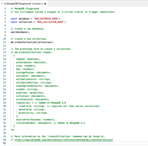

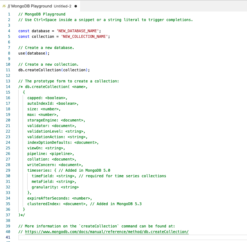

I’m using the username and password that I use for Atlas and to connect in VS Code. In VS Code I am "currently connected to mongodb+srv://username/password@sandbox.vd7qxrw.mongodb.net. I can see “MongoDB Playground” but have been unable to use it.

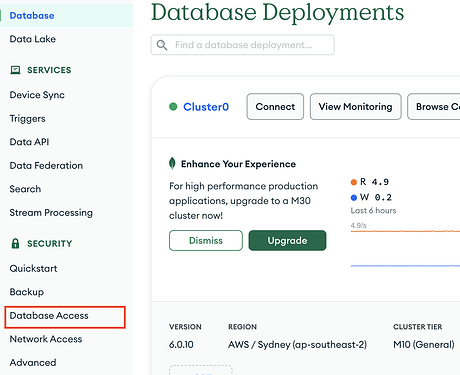

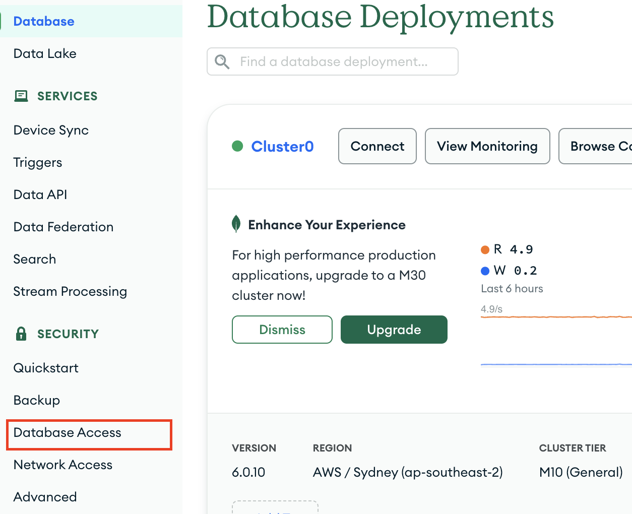

You won’t need to create a new Atlas account or change the Atlas account’s password. What I was suggesting to test is:
  1. Log into Atlas (In most cases, this is with email and password)
  2. Navigate to the Database Deployment section for the cluster you’re trying to connect to with Compass.
  3. On the left hand side, you should see something similar to the following example:
  4. You can then click the red highlighted Database Access tab and re-configure Database User from here.

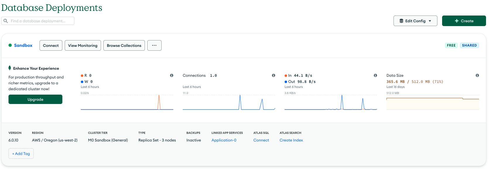

Do you have access to the Database Deployment for this “sandbox” cluster? I.e. can you see it when logged in the Atlas Web UI? If you can provide any screenshots, that would be helpful too (redact any personal or sensitive information before posting here).

When I’m logged in, I see my name in the upper right corner and when I click on Database this screen is returned. When I click “Browse Collections” I can see the ones for my class.
