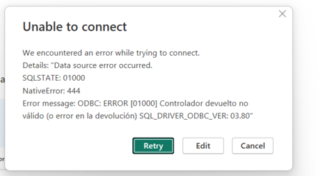

Hi! I have tried everything you have shared and still getting this error:
Welcome to the community. This error results from a failure to connect and is usually from: Incorrect credentials, bad/wrong SQL URI/Connection string, or IP Address is not whitelisted. I have also seen systems that have fire walls in place that block connection too.
@Carolina_Silveira - do you have a private endpoint configured for this Federated DB? A private endpoint can add another layer to this.
Are you able to connect to this federated db instance from Compass? Not connection to the cluster, but to the federated db instance with the same user credentials as used from Power BI.
