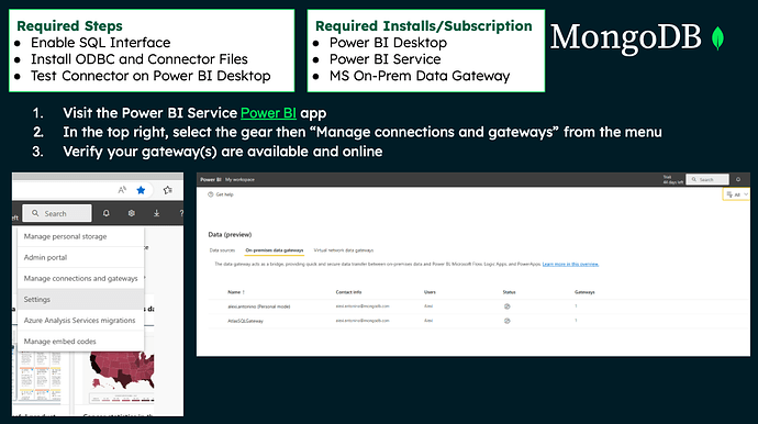

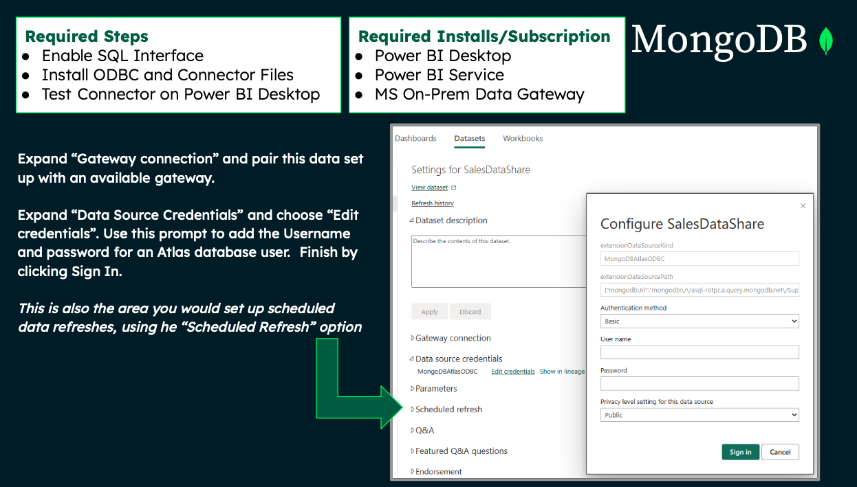

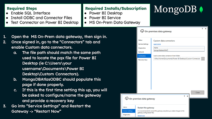

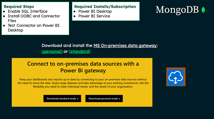

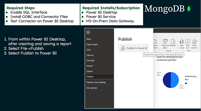

Hello @Vincent_Quillet - welcome to the community. While you may use the BI Connector, it too requires an on-premise gateway when using Power BI Service. Also, Atlas SQL will eventually replace Atlas BI Connector.
With the Atlas SQL Power BI Connector you can download the Connector and Driver and configure your on-premise gateway with this connector. Download and install the Connector and ODBC Driver here.
Here are some steps to follow for the Gateway:
Let me know if you need more guidance!

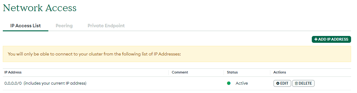

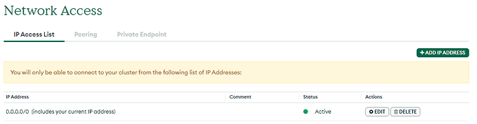

Hi guys!
I fixed that issue in Power BI Service by creating an IP Address 0.0.0.0/0, as you can see in the image
Now my cluster can be connected by any IP Addresses…
I hope it helps you!
@Flavia_Santos_de_Almeida thanks for letting other users know of this. I also want others to know that IP Address 0.0.0.0/0 is great to test connections, but then you can isolate the IP Address (say from your computer or the computer running the BI Tool - like Power BI Desktop) and add that instead of all zeros.

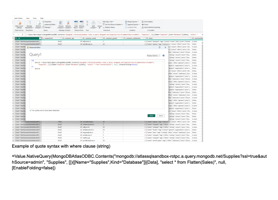

while using direct query form mongo db bi connector in power bi desktop, unable to get data in tabular format, some column level information is missing and also some columns are showing in Json format, can you assist me to over come from this. Thanks in advance.

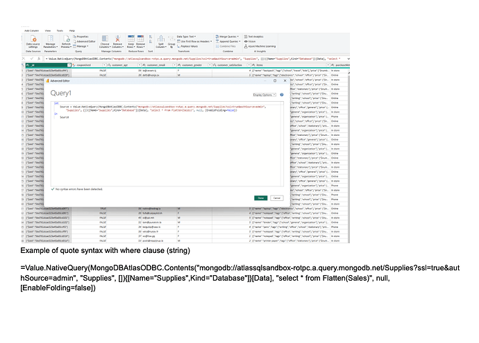

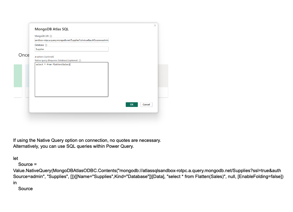

Hello @Kuppili_Kishore I will answer here, but this isn’t really a “connection” problem as the first post was. It sounds like you connected without a problem, but missing fields or Json fields. If there are fields not showing up, you should manage the SQL Schema within Atlas. You can do this within the the Atlas UI, within the Data Federation tab.
If you want to know how to transform the nested objects and arrays, you can do this using the passthrough SQL on connection or within PowerQuery. Here are some instructions of the mongosql dialect: https://www.mongodb.com/docs/atlas/data-federation/query/sql/query-with-asql-statements/
You will want to use the “Flatten” command or dot notation to split out fields nested within an object into their own columns. Then you will want to use the “Unwind” command to unwind arrays.
Here is some sample mongosql for example:
Select Cast(_id as string) as _id,
couponUsed, customer_age, customer_gender, customer_satisfaction, items_name, items_price as price, items_quantity,
(items_quantity * items_price) as totalPrice,
storeLocation, saleDate, purchaseMethod ,
cast(saleDate as Timestamp)as testDateTimestamp,
SUBSTRING (Cast(DATETRUNC(DAY,saleDate)as string),0,10) as DateOnly
from Flatten(Unwind(Supplies.Sales with Path=>Sales.items))
where items_quantity = 2
limit 100
