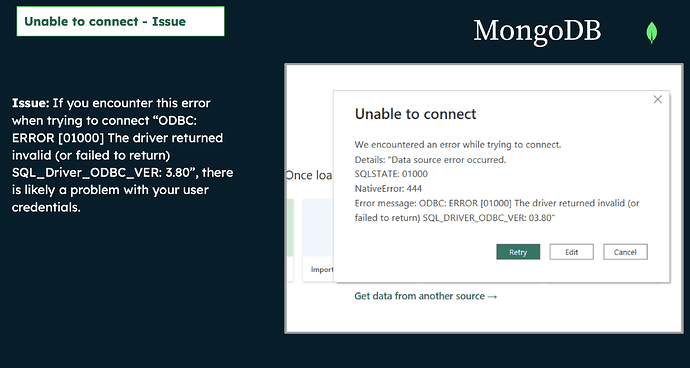

I am trying to connect power bi with mongo DB and get this error
Wer encounter an error while trying to connect.
Details: "Data source error occurred.
SQLSTATE: 01000
NativeError: 444
Error message: ODBC: ERROR [01000] The driver returned invalid (or failed to return) SQL_DRIVER_ODBC_VER: 03.80
I follow the guide in the website step by step.
ODBC Driver Download :1.0.0 (the latest)
Power BI Connector Download :1.0.0 (the latest)
Power BI Connector Vertion :Version: 2.118.1063.0 64-bit (June 2023) (the latest)
hello Sahar! Welcome to the community. This error usually indicates an issue with your user credentials. And because of caching on the MS Power BI side, if you just messed up the password on the first try, then put in the correct one, this error will still be present. Take a look at these instructions to help remove this error/blocker:
Are you able to connect to your Atlas SQL Federated DB via Compass or MongoDB Shell (using this same user if and password)? This will help us validate the user credentials.

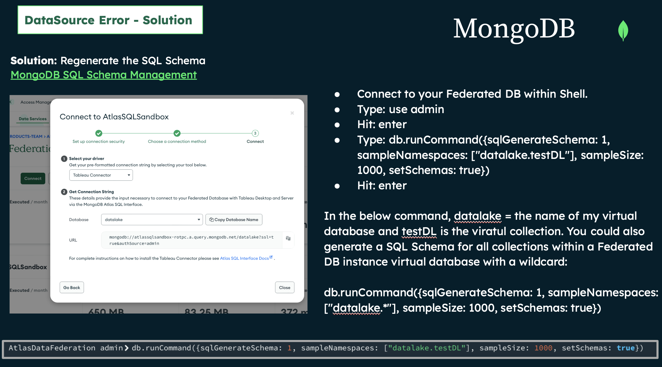

Great! Thanks! I could resolve my problem, so, now, when my data is loading power bi show this message: “This query does not have any columns with the supported data types. It will be disabled from being loaded to the model.” any advice?
Hey All - if you are able to connect, but then get a message about no columns, it could be because of the SQL Schema. Take a look at these steps to get/generate the SQL Schema. And here are the online docs about SQL Schema Management.

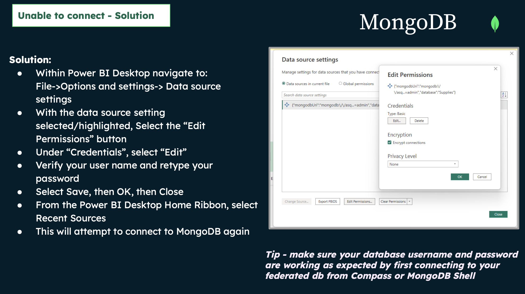

Hi All - Here is a possible way around this error (see image below):
Also, make sure you are using a MongoDB Database User/Login and not the credentials you use for Atlas. And one more thing to check is that your IP address is whitelisted.
