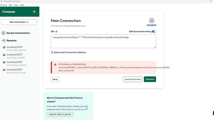

Can anyone help me in resolving this issue

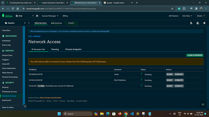

You need to add your IP to the Atlas access list. Try this and if the error persists, let us know here.
even I have added the IP address. although the error is not solved. What can i do?
the error comes while i connect the mongodb compass through atlas cluster connection string
I experience the same problem. My IP-address is whitelisted in the Network Access settings, plus I added 0.0.0.0/0 to allow all IP-addresses.
Unfortunately this did not help, I still can’t connect to the cluster.

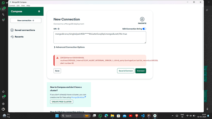

Try without tls=true to validate.

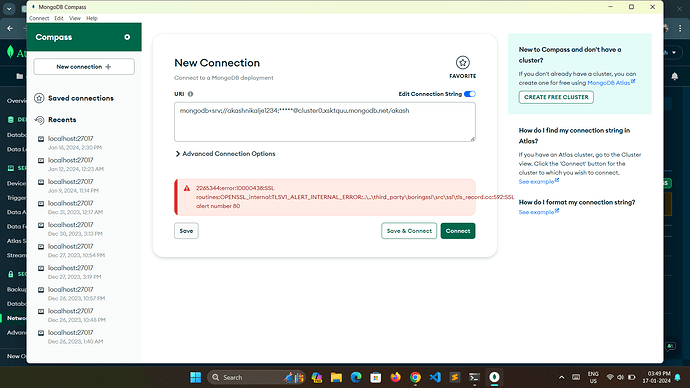

I have added the IP address. but the error is not solved. what to do now?
What error does it return?
Are you using an M0 cluster? Have you verified whether it is the same case as above?
yes i am using M0 cluster
Do the IP Addresses still show as pending as they do above?
There are cloud issues on shared tiers, so this could be causing the issues with the IP Address settings not updating.
You can monitor it here, I’d wait for this to be resolved and try to add your IP address and connect again.
Yep, looks like this is because of the Atlas issues that are going on currently.
