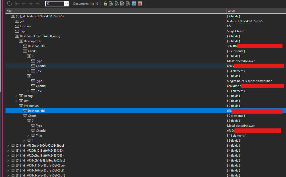

Any new update on this? We decided on charts over power bi because we can embed query parameters in the token when embedding. One rather large issue we are running into is that when we import the charts the dashboardid and chartid change. There is no way to “update” existing chart from import. This means that we have to track chart id’s and dashbaord id’s per environment and also update them on the fly whenver we have to import the update dashboards in our production environment. Unfortunately this means customer will experience down time as we manually update chart id’s and dashboard id’s Example of the types of conversations I am having with my developers.

I think there might be more value in fixing this Id issue first and then coming back to the API. It could probably save me between 20 and 40 minutes every time we have to release. Even better is if we could just point it to a git repo and you could specify a branch or tag that would be used to update existing charts (still would need to fix the id issue). I version control every chart export so we can track changes and then have to manually import/fix chart and dashboard id’s. Every release i have to udpate these id’s. We store the dashboard and chart id’s in a collection for convenience.
