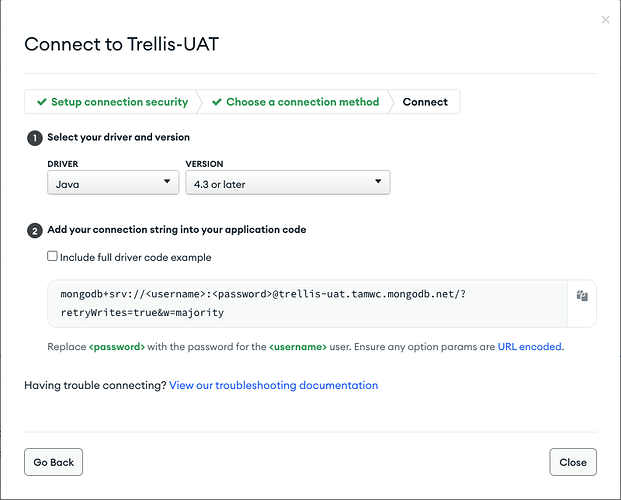

Regarding the URI, here is my real uri:
  • mongodb+srv://<username>:<password>@trellis-uat.tamwc.mongodb.net/?retryWrites=true&w=majority.
Thats the connection string I am given from the Atlas web portal. I’ve attached an image below for your reference. I do swap out the <username> & <password> parts of the URI for an actual username and password but yeah, it doesn’t work. What’s strange is I’ve used this connection string for the last two years or so and it’s worked fine up till about two or three months ago. Furthermore, I have deployed my application to external servers and it is running well on those servers. It can connect to the Mongo database even now but when I run the application on my PC, it fails to connect and keeps throwing the aforementioned exception.

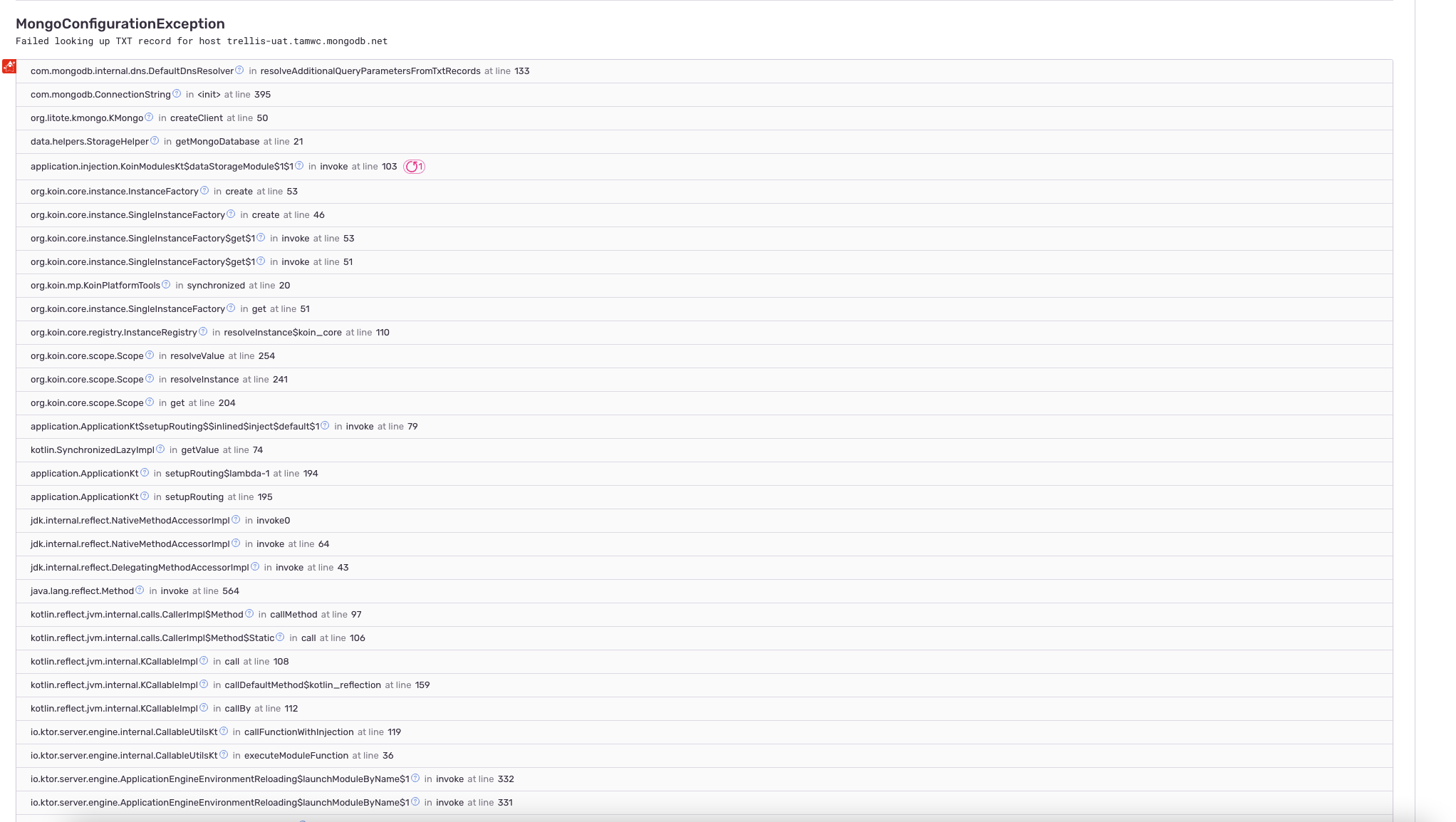

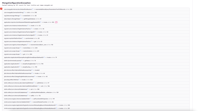

Here is a photo of the error messge I’m getting (top exception)
Here is the underlying cause (underlying exception that is caught and then throws the one above :point_up_2:)
The exception underlying the one above: (root exception that is caught and then throws the one above :point_up_2:)
