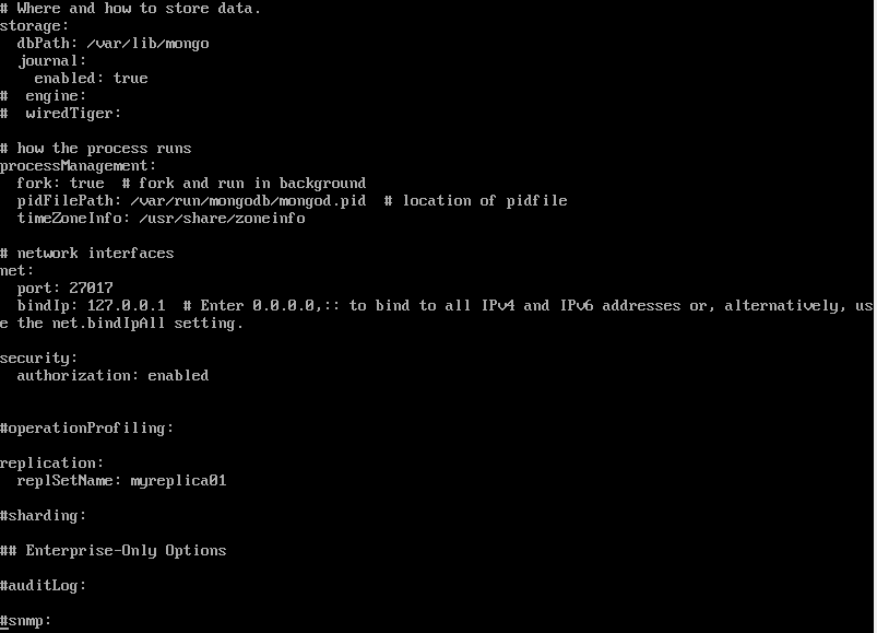

uncomment replication line 36, and set the replication name to,
replication:
replSetName: myreplica01
therafter, mongod service is unable to start.
i am referring to this,
it is possible you have removed too many spaces there. mongodb config files are YAML in essence and indentation matters. please check this first.
if that does not solve, try sudo systemctl status mongod to see if error is written there and check /var/log/mongodb/mongod.log (or the file set systemLog.path in config file) to see you can see the error.
its perfectly working in one node. then I copied the same to other replicate 2 nodes. (bindIP is set to 0.0.0.0).
when i comment replcation mongod service is working. when uncomment its not working??
replication:
that does not seem an issue from database server, but rather you missed some settings while creating other servers.
from that link you gave, please make sure you followed every step from 1 through 4. as your edit on /etc/mongo.conf file requires an edit only on 2 lines, you could do that without copying. when all servers are identical, they should all work fine without a problem.
also make sure that lines has correct indentation (2 spaces it seems):
replication:
and instead of using 0.0.0.0, just comment out that line with a hash sign # bindIP: 127.0.0.1
This is insufficient for us to help you.
You have to share the error message you when starting the service and you also need to share the errors you get in the logs.

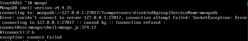

hi,
Any particular reason for mongod service is running but when type mongo, generate an error as below,
anytime you forgot to “run a server” to “listen at a port” on a specific IP, then the connection will be refused by that IP’s system, or you have the wrong connection string.
i am working on oracle linux v8.5, not on windows.
mongod service is running but cant get in to mongo shell?
look, you are not helping us to help you. you are not giving us any configuration details nor any error logs we pointed out.
any operating system will refuse you if you try to connect to a port that is not open for listening. and you are trying to connect to such a port. not to mention the IP you are trying to connect might be wrong.
why it happens? clearly, you are doing it wrong in one of the steps. is your mongod really running on all servers? are you using the correct port numbers to connect? did you set all firewall rules so OS allows you to connect? are you using the correct IP of your servers to connect? are those IP addresses set to allow remote connections by the router they are on.
so far, you haven’t tell any of these details. All I have is a link to a blog post you say you followed, and its content seems to work when followed correctly.
more on that, “connection refused” is not somehing related to “mongod” processes.
Now please, take a breathe first and kindly check all the steps you are supposed to do, make sure all are good, then show us error logs other than “connection refused” error.

I did everything again and moment i enter,
replication:
save and restart the mongod service, it does not start??
