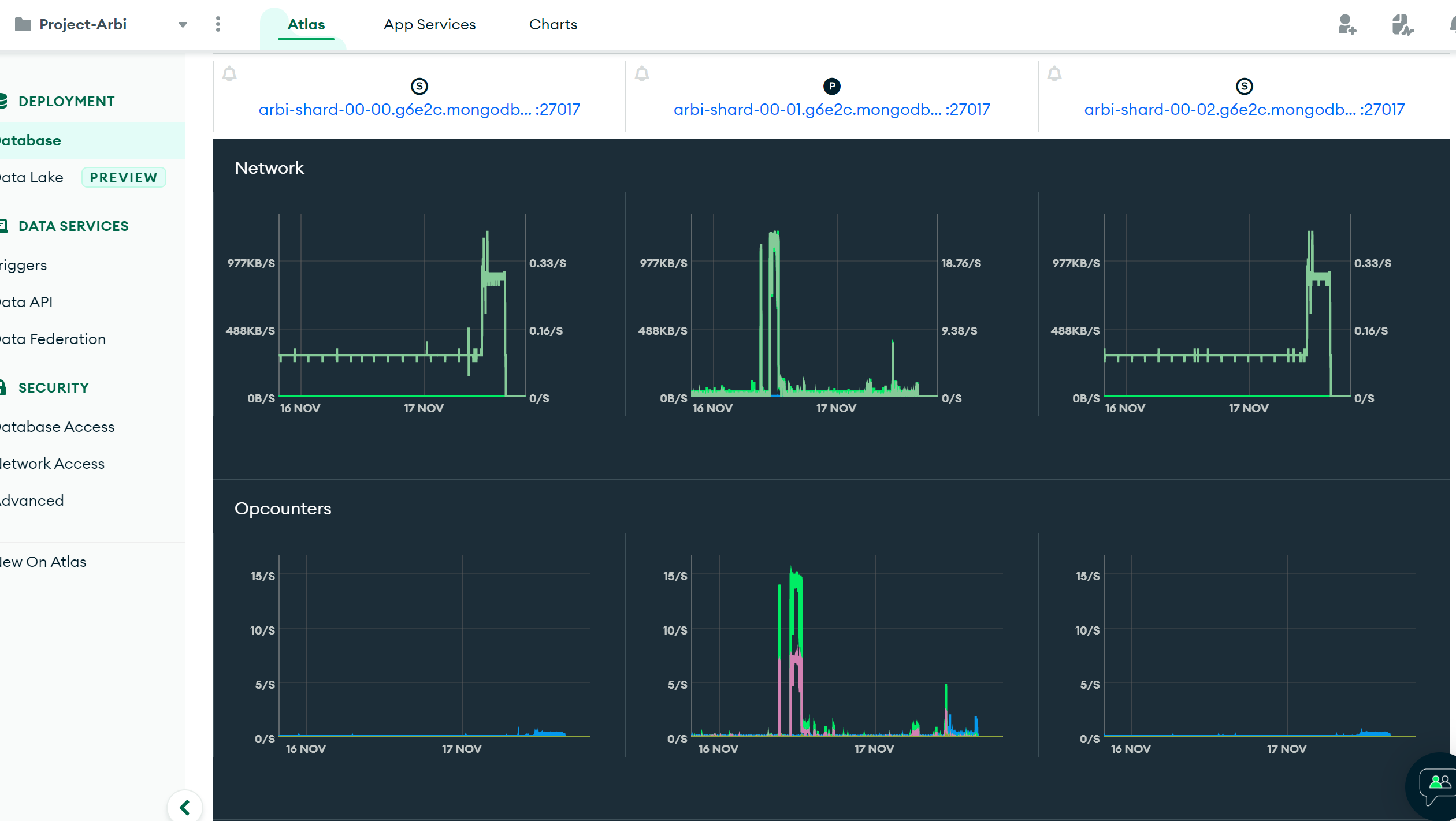

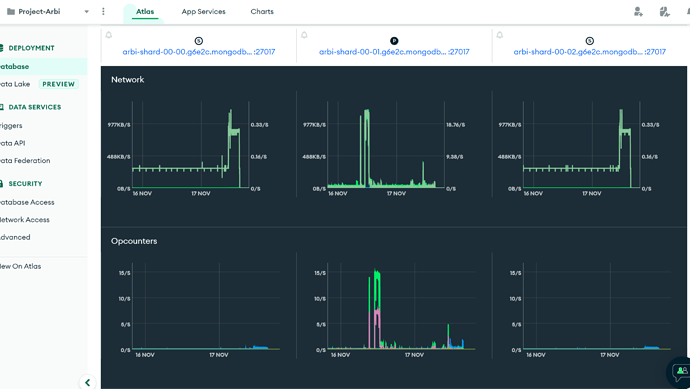

To answer your questions, I do have a M0 cluster, but I have never experienced this kinda of sluggishness some results taking 30 seconds plus.
I was just throwing ideas out there about the driver being the issue, but I have no evidence of that. Maybe these screen shots can shed some light.
I uploaded an image of the last 48 hour or so when the DB started being very slow.
(I cant upload all the images I have as a new user) To me these seem like smaller but it the lag was very high.
I use to use connection incorrectly and exceeded the maximum connections, but since fixing that code I haven’t had issues until now. I don’t have great understand of the metrics and what they should mean for performance, that’s why I mention connections since that’s the only known issue I have had.
I was making more write than before with some new code, but that had been running a week or so and didn’t seem to cause issues. I also started making a React site that might have been using my API to access the DB a little more than I thought. The only reason I not sure that’s the case because even after disabling all that code I continued to have very bad performance.
I hope this can help with coming up with a solution or at least figure out my problem.
last 48 of original DB:
Thanks,
Thanks for providing those details Justus.
As per the limitations documentation currently M0 free clusters and M2/M5 shared clusters limit the total data transferred into or out of the cluster in a rolling seven-day period. Specifically for M0 this limit is 10 GB in and 10 GB out per period. The limit itself noted here is for the cluster as a whole as well. This means that if the total sum of network data transferred for all nodes exceeds the limit, then the throttling will occur.
One of the key point here is that the limit is based off a rolling seven-day period.
So I moved the data to a new DB and seems to be back to normal.
I understand that you’ve moved from one cluster to another in which the issue was resolved. If you encounter this again on the new cluster, I would recommend contacting the Atlas support team via the in-app chat to see if they are able to confirm if you’ve past that particular limit.
