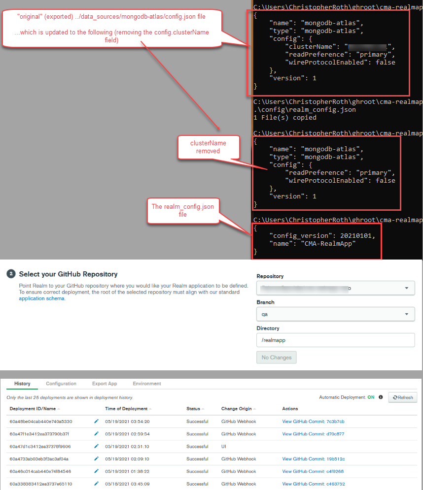

I’ve configured the GitHub auto-deployment to deploy our Realm app from our DEV env to our “next,” env - QA. I’ve gone through the tutorials, and our company has had a recent “accelerated” consulting engagement - and this was all POC’d and working fine with two personal/free-tier Projects & Realm-apps (exporting with realm-cli beta 4).
However, what I see now is that “mechanically” the auto-deployments are working (evident by the History tab) - but it seems that ONLY the Functions, Triggers, Values & Auth Provider of the app are deploying (and NOT the Schema, Rules, and GraphQL Schema/Customer Resolvers) - even though I clearly see all the json files under the data_sources/mongodb-atlas sub-structure (with the db and collections).
Other notes:
- current realm-cli is 2.0.0.-beta.5
- the realm_config.json only has the realm app name and config version fields (all other fields removed), and the data_sources/mongodb-atlas/config.json has had its config.clusterName field removed - see screenshots below.
Screenshots:
So with that - is there something that I’m fundamentally missing? I’m happy to provide any other info that might help.

Hi @Christopher_Roth.
I wanted to check a couple of things.
Was the app exported in the new format, if you’re not sure then it would be good to export it again?
What happens if you try to manually import the app using realm-cli?

I just created a new app, exported it, added it to GitHub, and then linked it to a new app.
The only change I had to make to make it work was to change name in /realm_config.json.
I no longer need to remove config.clustername from /data_sources/mongodb-atlas/config.json - looks like that’s been fixed.
I checked the directory structure for data_sources and mine seems to match yours.

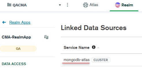

Does the linked data source have the same name (mongodb-atlas) in the app you’re trying to import into?
Hi @Andrew_Morgan - thanks and no worries. I appreciate the update & will take another crack at it here this afternoon (and be prepared to do a realm-cli import, if it doesn’t appear to work). And yes, our target env’s realm-app has the same linked source name of mongodb-atlas -

Hi @Andrew_Morgan - apologies, it wasn’t until today that I was able to get back to this. I still see the same results - and that being that the Rules & Schema content are deleted upon a “successful” auto-deployment via GitHub.
I’d un-installed and re-installed the realm-cli (now beta 6); being on windows, I toggled the git core.autocrlf configuration setting (to ensure that only LF chars remain in the files upon commit into GitHub) - but all resulted in the same.
So, I re-imported the app into our QA env via the realm-cli import command (which works) to ensure the app’s successful deployment in that env, but I’m back to being at a loss as to what else to try.
Is there a new GitHub Mongo app that I should re-install in GitHub?

I think our situation is that a) our project has only ever been on the “new Realm directory structure,” and b) I went ahead and opened a Mongo Support ticket (for this topic) last week, and demo’d the behavior to two Mongo support engineers late last week. And from that session, I think I we identified our issue - and that is, in our GitHub repo… the Realm app content (its full directory structure) was checked into a sub-directory within the repo (and not into its “root”), and even though the Realm deployment config specified that sub-directory (to deploy from), well - that was the issue. I created a second/new GitHub repo (with no sub-directory for the Realm app, and not other content), and just committed the Realm app into it (at the root) - making the typically realm_config.json and data sources config.json updates - and when merging from one branch to another, it all deploys fine to the target/QA env (incl. the Rules & Schema).
So now I’m just waiting for one of the Mongo support engineers to replicate my scenario (given a GitHub repo with a sub-directory that contains the Realm app content), and confirm whether he sees the same / what we all observed when working together.

Hi @Thomas_Juel_Andersen - sorry, I’d never followed-up to my last Post. Mongo was able to reproduce my issue (of the auto-deployments not deploying the Schema/Rules, if the Realm app structure is versioned-controlled in a sub-directory structure of a GitHub repo, and not at the root) - so, from my Support Case, a ticket was logged with the Realm engineering team. So, we pivoted to just having a flat GitHub repo for our Realm App (so that this was no longer an issue for us), and all of our auto-deployments have been successful since (over the past few months, deploying weekly or over two weeks). That said, I just followed-up on my Support Case (asking if there are any updates form the Realm engineering team); I hadn’t received any updates since late June (other than it was in the Realm engineering team’s hands). And, I haven’t (yet?) observed the issues that Simon’s described.
