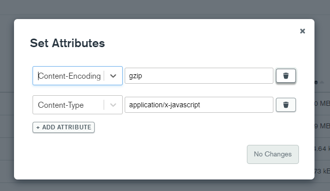

- Via the Realm UI, I remove the gzip Content-Encoding (see image below) and save - this fixes the site (however the file is no longer compressed as before)
