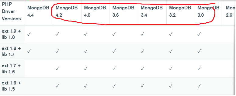

which version of these are you using?
is you mongodb version one of these?
In the sense of a MongoDB client? If so, 4.4.6
in the sense of your mongodb server
