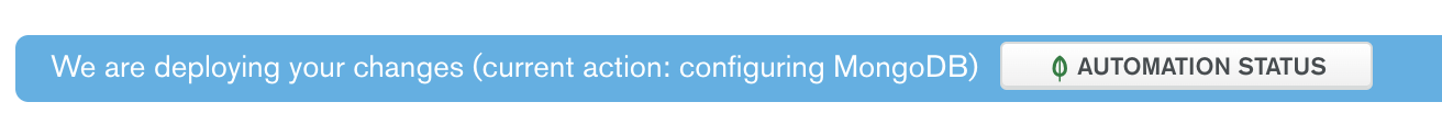

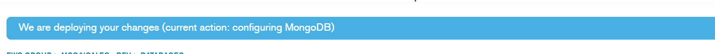

  3. After running the above command, quickly switch back to the Atlas UI and check if the following are shown:
  • A blue bar at the top of the database deployments section:
User performed a Data Explorer CRUD operation, which modifies data
Username: abcdefgh /// this is a altered public api key for example purposes
Operation: createRollingIndex
Database: testdb
Collection: testcoll
Changed by an API key with Public key: abcdefgh from 159.xx.xx.xx
Note: The blue bar indiciating changes are being deployed could be for another change to a resource in your project but it’s a good thing to check during the time of index creation as well for troubleshooting purposes

I see the blue bar when I create a new index on the property but when it completes I am not able to see the index for any of the clusters. I don’t see it on activity feed too.

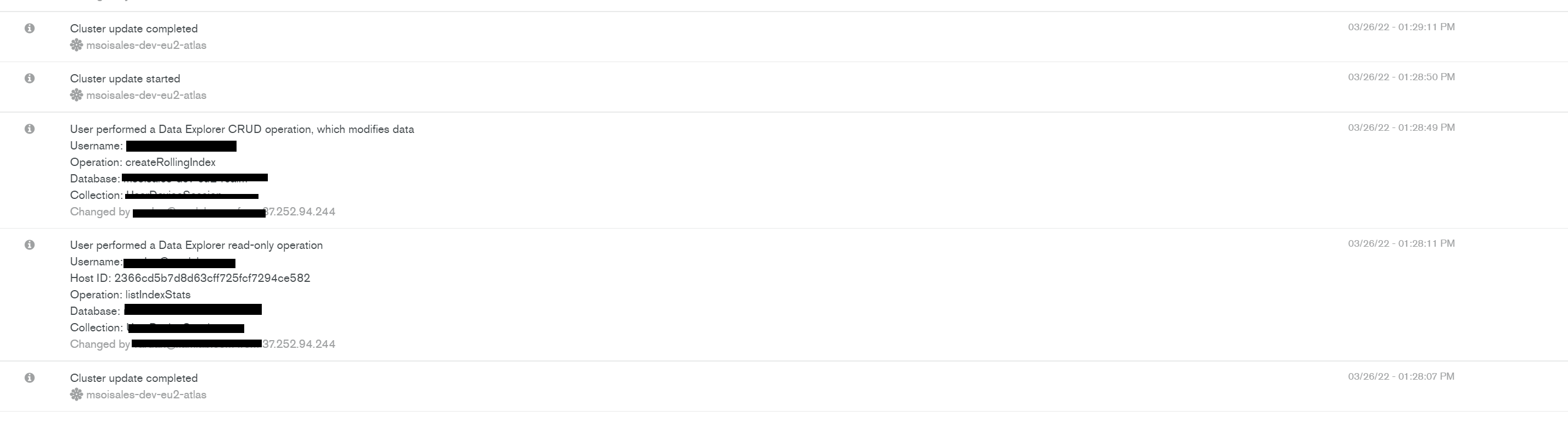

Update!
I just noticed that the cluster update appears on the projects activity feed. But when I navigate to the Atlas → Browse Collections → Select Collection → Indexes I don’t see the index there.
One more thing which I have noticed is the different operation types on the activity feed depending on how I create an index.
When I do it with MongoCli or API the project’s activity feed shows the Operation: createRollingIndex whereas when I create an index manually the feed shows Operation: createIndex
