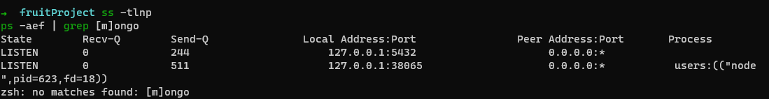

Please share a screenshot that shows exactly how you start your application.
If mongosh can connect, your application should connect.
Are you using docker or some other container to start the application?
I do not know exactly which commands are available inside WSL terminal, but the output of the following (if available)
ss -tlnp
ps -aef | grep [m]ongo
I’m not using a container or docker I think
this is what I get running those commands
what is the second command trying to do?
