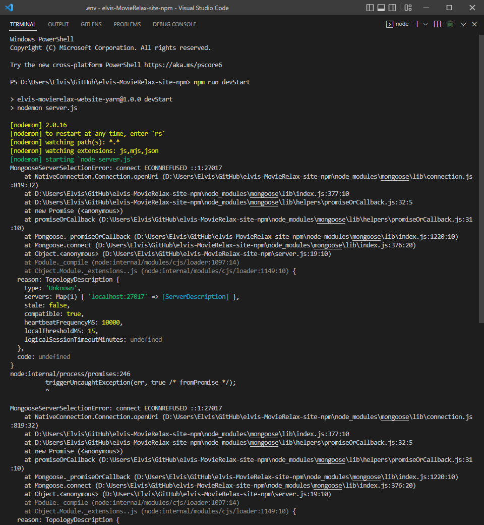

Hi everyone, I have been having this issue since few days ago, when ever I start my node server I got this connect ECONNREFUSED ::1:27017, my mongo service is running; I have used several approach uninstalling and reinstalling agian momgo

Your connection refused message indicates an attempted connection via the IPv6 localhost alias ::1 (0:0:0:0:0:0:0:1).
By default mongod does not bind to IPv6 addresses: you would have to set net.ipv6 to true and add appropriate IPv6 addresses in net.bindIp.
If you are using the default mongod configuration you should be able to connect to localhost:27017 or the equivalent IPv4 address 127.0.0.1:27017.

Hi @Stennie_X,
I’m experiencing similar issues when trying to connect with MongoDB using mongoose.
mongoose.connect('mongodb://localhost:27017/MovieApp')
Works fine when changing the URL from localhost to 127.0.0.1. My operating system is a M1 based macOS. I’m running MongoDB as a (i.e. the mongod process) macOS Service**

Same here. MacOS running on M1 Pro, having localhost in the env file does not seem to work. I changed to 127.0.0.1 and it works perfectly.
I have the same problem with macOS Monterey running on Intel: I can connect with 127.0.0.1 but not with localhost using MongoClient.
