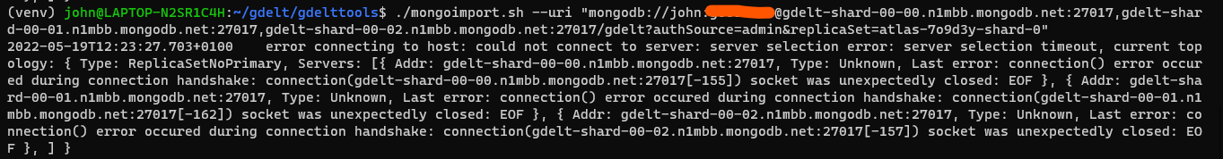

I’m getting a
After last host:port in your connect string add / before ?
I think you’re right. I missed a / :man_facepalming:
"mongodb://john:PASSWORD@gdelt-shard-00-00.n1mbb.mongodb.net:27017,gdelt-shard-00-01.n1mbb.mongodb.net:27017,gdelt-shard-00-02.n1mbb.mongodb.net:27017/YOURDATABASE?authSource=admin&replicaSet=atlas-7o9d3y-shard-0"
Don’t forget to put your database name in, either - mongoimport.sh requires it.
Thanks Mark and @Ramachandra_Tummala . I actually tried this already after I observed that @Joe_Drumgoole had a /test in his blog post but it gave another weird error which I frankly didn’t want to bother anyone with again :sleepy:
But I’ll share it here and try again later cause I fear it has something to do with my network

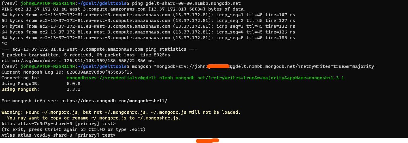

I’m starting to think the network you’re on is quite restricted. Can you try pinging one of the nodes, like this
ping gdelt-shard-00-00.n1mbb.mongodb.net
If you get something like the following then you might be able to access the replica-set:
64 bytes from 40.67.234.22: icmp_seq=0 ttl=50 time=29.413 ms
64 bytes from 40.67.234.22: icmp_seq=1 ttl=50 time=29.855 ms
64 bytes from 40.67.234.22: icmp_seq=2 ttl=50 time=29.782 ms
64 bytes from 40.67.234.22: icmp_seq=3 ttl=50 time=29.692 ms
If you can, then try using mongosh directly to connect to the replicaset using your SRV connection string, and then the comma-separated connection string, and see what the results are.
If the ping times out then there’s a good chance you just can’t connect to MongoDB Atlas over the network you’re on.
I just tried these and I’m able to both ping one of the nodes and connect to the SRV string using mongosh

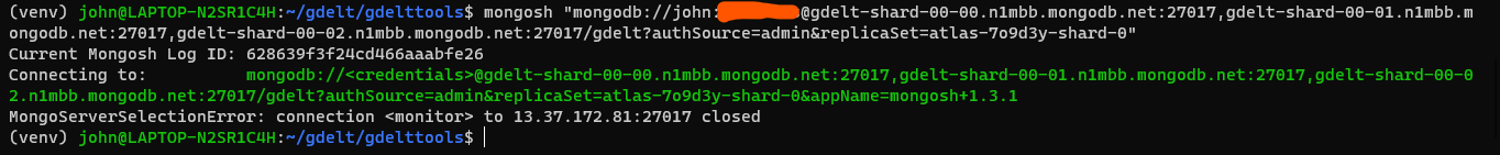

However, connecting to the comma-separated connection string gives this:
:grimacing: Okay! I think it’s starting to look like @Joe_Drumgoole was right when we were talking about this issue this morning - I think there’s a bug in the script, but I can’t work out how to fix it exactly. Please change the last block of the script so it looks like the following, and paste in your connection string:
