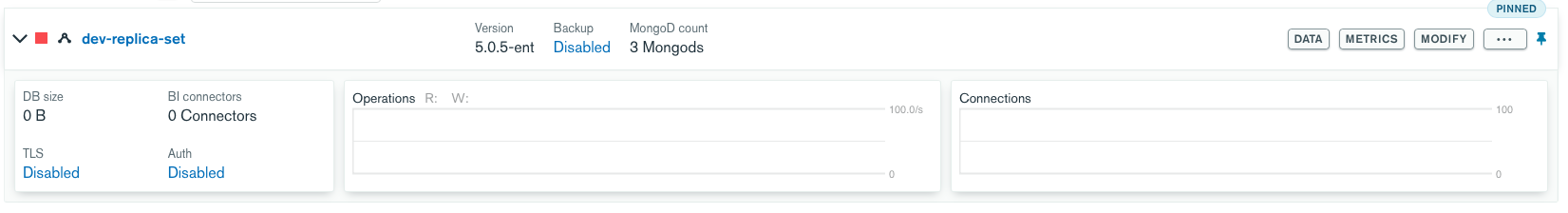

i have a k3s cluster with six nodes on which I deployed MongoDB Enterprise Kubernetes Operator. The Operator ist working fine and behaves generally as expected.
My problem is that MongoDB Ops Manager says the primary member of my replica set unavailable:

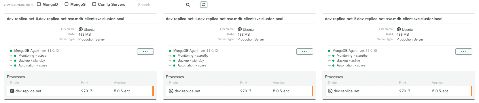

Checking the “Servers” tab in MongoDB Ops Manager tells otherwise:
As you can see the MongoDB Members are working as expected with all the features enabled. Also, the “Metrics” tab shows all the metrics I am interested in. Furthermore, these findings imply that MongoDB Automation Agents are working correctly too. So I come to the conclusion that all components, that is mongod and mongodb agent, are well and healthy which is confirmed by the logs of MongoDB Operator:
