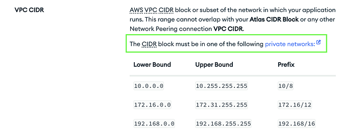

while using 11.0.0.0/23 is giving error as “Route table CIDR “11.0.0.0/23” is not in private range”.
As per the step 3 of the Configure Network Peering for an AWS-backed Cluster procedure, the configured VPC CIDR block range must be within the ranges (as of the time of this message) :
Jason
Hi @Jason_Tran , I get that. Thank you for response.
Is there any alternative to peer other CIDR? This one is required because my production VPC CIDR starts with 11 and that can’t be changed.
