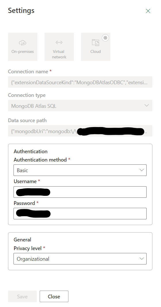

Prior to the release of the named connector, I set up scheduled refresh using a personal data gateway and a System DSN configured for my MongoDB database. I was hoping the named connector might remove the gateway as a dependency…
One other observation… When I try and configure the connection in the Power BI service through the Settings > Manage connections and gateways link, the Save button remains disabled, even after I enter valid values in to the required fields.

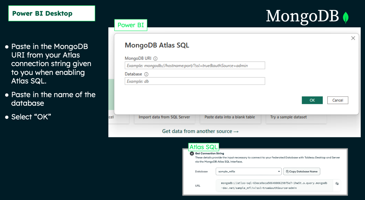

Hi, I’m also trying to query Mongo (just a test db at the moment) with Power BI and also getting nowhere, same message “Missing client library for datasource”.
PowerBI (desktop at the moment) asks for a MongoDB URL, and a “database” which as an SQL guy I assume is a tablename. I use the Atlas DB connector string, name the table, and get that result.

First up, the error “Missing client library for datasource” most probably means you may not have downloaded and installed the Atlas SQL ODBC driver. Here is the download for that driver: Download Atlas SQL ODBC Driver | MongoDB
Next, when the connection dialog asks for “database” it is referring to a database name, not a table. This is just the database to authenticate against and you will be able to build upon other databases within that cluster/Federated db, so long as you have permissions to those.
And if you want to publish and refresh this data, a Power BI Gateway is required. So if this gateway is on a server, the connector and driver must also reside on that server. You can download the connector and driver from our download center (as mentioned above).
