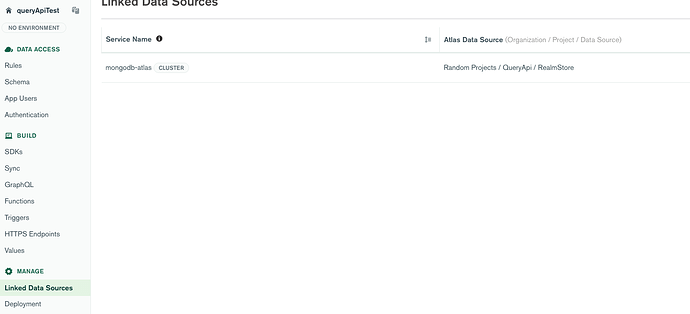

mongodb-atlasis your Data Source name which can be found from your mongodb cloud account
- Sample_airbnb is the database that is part of Atlas data-set and can be loaded by following instructions at Load Sample Data. A screenshot from cloud is as below

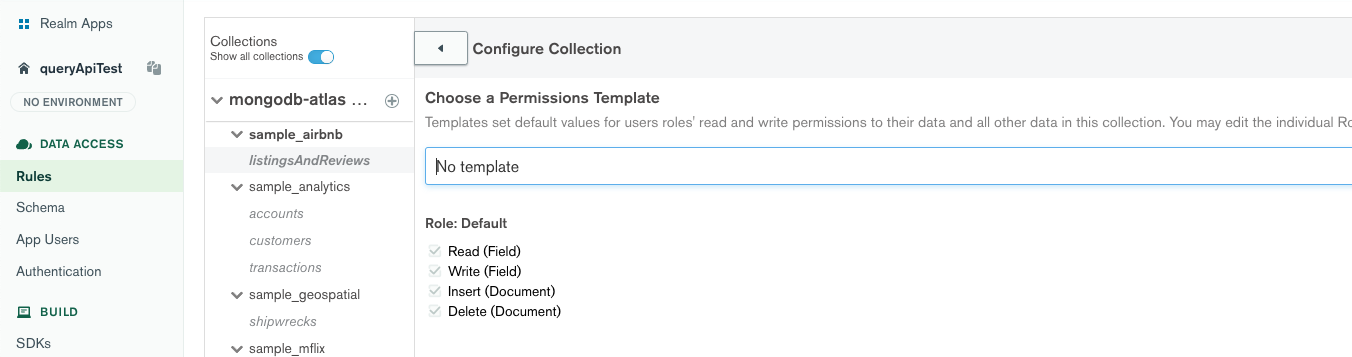

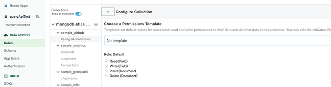

When Sync is not enabled, MongoDB Rules for the particular collection you are accessing need to be defined from Rules Tab as below:
If no rules are defined, data access operations will fail with an error similar to:
E/EXAMPLE: failed to find a document with:
SERVICE_UNKNOWN(realm::app::ServiceError:-1): no rule exists for namespace 'sample_airbnb.listingsAndReviews'
