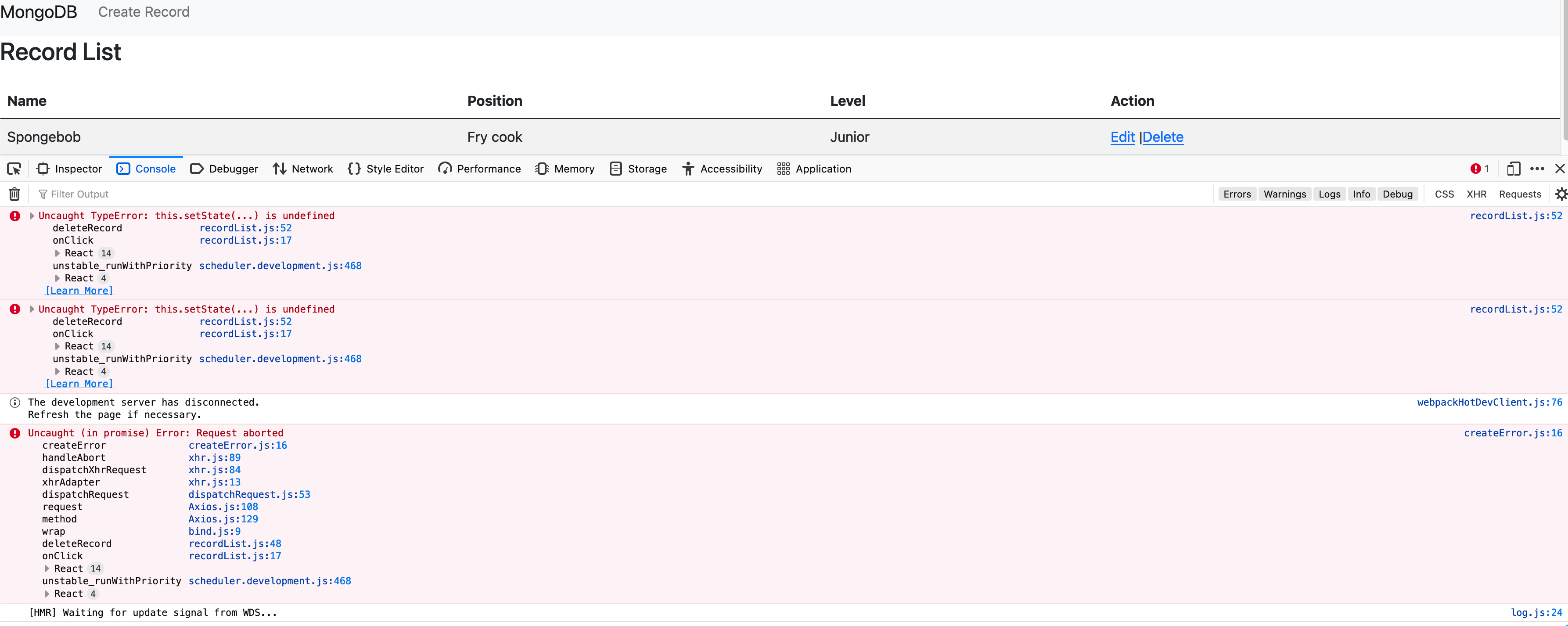

I am new to the MERN stack and came across your awesome tutorial. I believe I have everything up and running just fine, except I can’t seem to get the delete method to work. Create and edit both work (I can see the change locally and also within MongoDB Atlas).
Please see below screenshot:
Any feedback on this would be greatly appreciated!

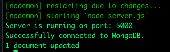

I don’t notice any errors on the express server side. Please see below screenshot:
Screen Shot 2021-09-11 at 1.58.40 PM
I’ve worked primarily with the code from the tutorial and have added in any noticeable changes from the git.repo. I can try to clone straight from the git.repo and see if that makes a difference.

Thank you for mentioning this. I caught this when I was cross comparing the code from the tutorial with the code from the git.repo and made the changes accordingly.

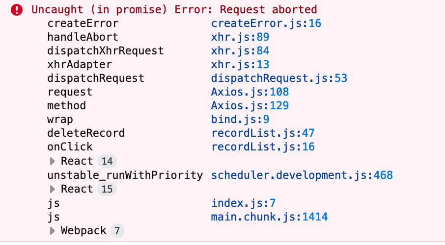

I attempted to test and clone the repo. For some reason the delete functionality still does not work. Create and edit seem to still be working fine. This is the error I received:

Hi @Pavel_Duchovny ,
Thank you for the update! I have tested the updated record.js file and unfortunately still receive the same error when attempting to delete a record:
I will continue to test on my ends as time permits and provide updates.
