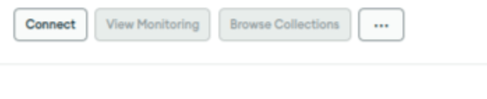

Hi @Kushagra_Kesav ,
Once the migration process gets started, I am not able to browse the collection through mongo atlas or any external client tool.
Browse collection button turns disabled during migration.
Since you pointed out that we can perform writes to the destination during migration , Do we have any way to perform those writes
Hey @saiprasanthkumar_P,
Could you access the database, or does the problem still persist? I’ll suggest raising a support ticket with the agreed SLA is the best option. Details on support plans are available through the UI as part of the procedure to change your support plan or by contacting MongoDB
