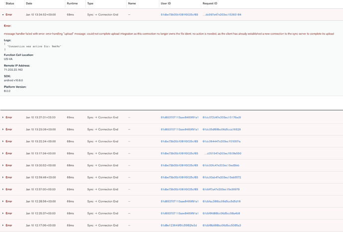

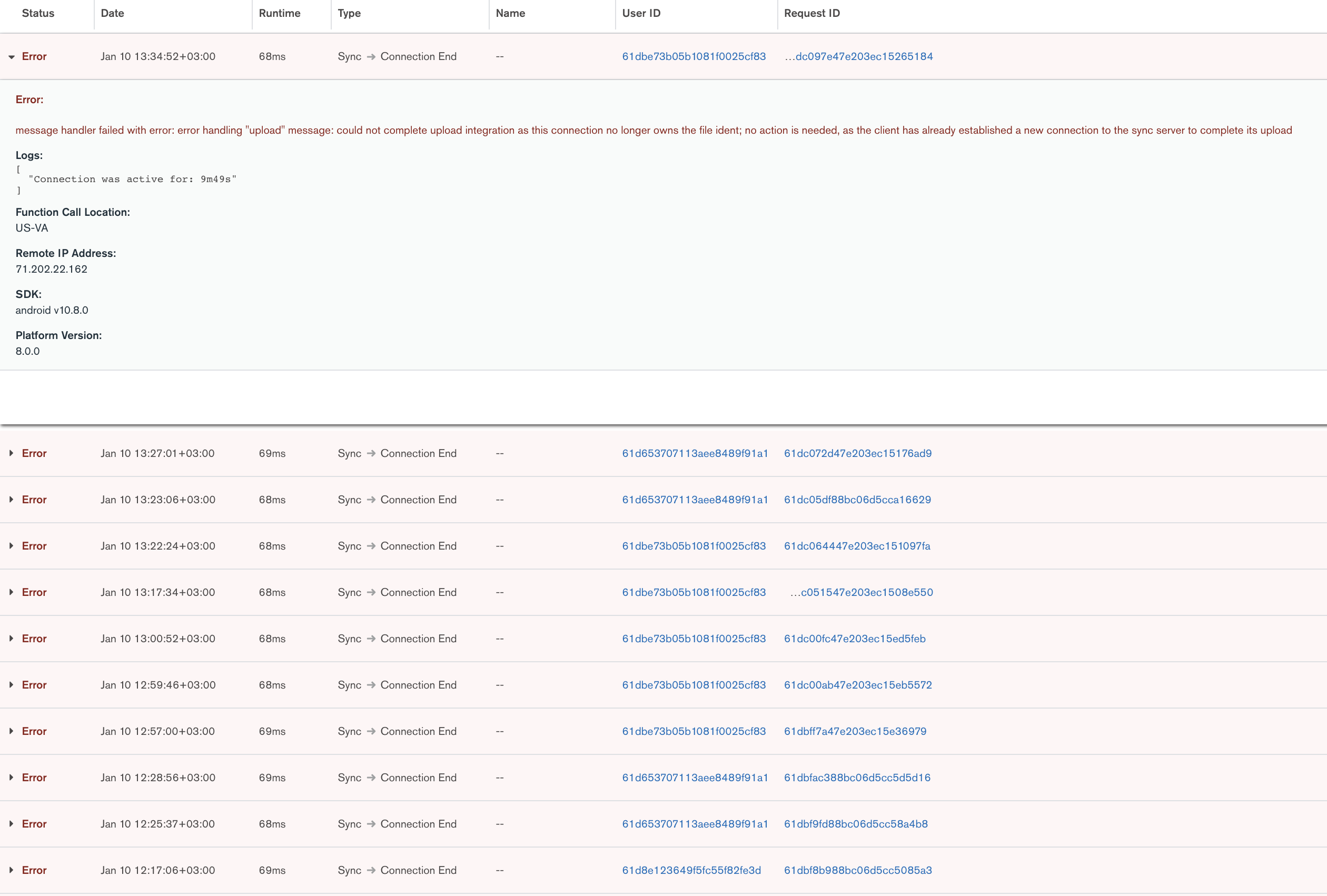

The error on the server is:
Error:
ending session with error: integrating 1 changesets failed after 1 attempts in 7.540692071s: could not complete upload integration as this connection no longer owns the file ident; no action is needed, as the client has already established a new connection to the sync server to complete its upload (ProtocolErrorCode=201)
Logs:
[ "Session was active for: 10s" ]
Partition:
PUBLIC
Session Metrics:
{ "uploads": 1, "downloads": 1 }
Remote IP Address:
81.102.24.215
SDK:
Realm Cocoa v10.15.1
Platform Version:
Version 15.1 (Build 19B74)
The important part (I guess) is could not complete upload integration as this connection no longer owns the file ident, but I don’t understand what it means. The part that troubles me is “no action is needed, as the client has already established a new connection to the sync server to complete its upload”, which seems to indicate that this shouldn’t be an error.
