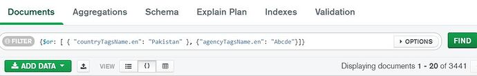

let say I’m running this simple query in my dataset
and it work fine but I want to show those document on top which match both $OR condition and those which match one condition show on last so for that I want to add score to each document if it match both condition then add score = 2 and if match one condition then score = 1 and then i’ll sort it with score.
but problem is how to calculate score for each document ?
