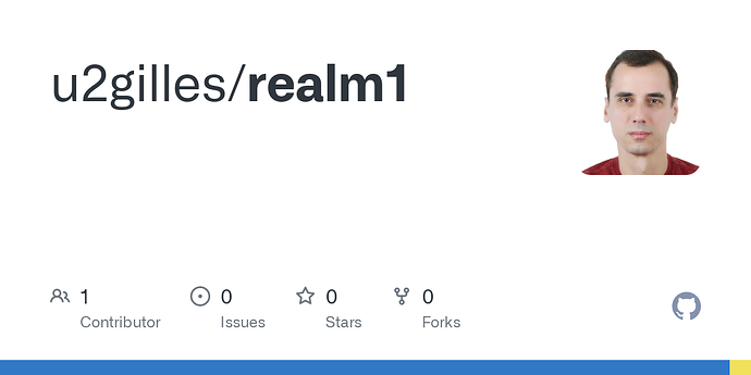

@Gilles_Jack , could you please share a repo or a package.json file?
I had to change Task.ts (without babel) and I added some nice traces.
I tested it on my Android device with USB cable and I used the local Expo CLI recomended by expo not the global one recommended by mondoDb. That’s another proof that MondoDB does not maintain and test Realm on React Native at the moment.
npm install
npx expo run:android (first time)
npx expo start --dev-client
