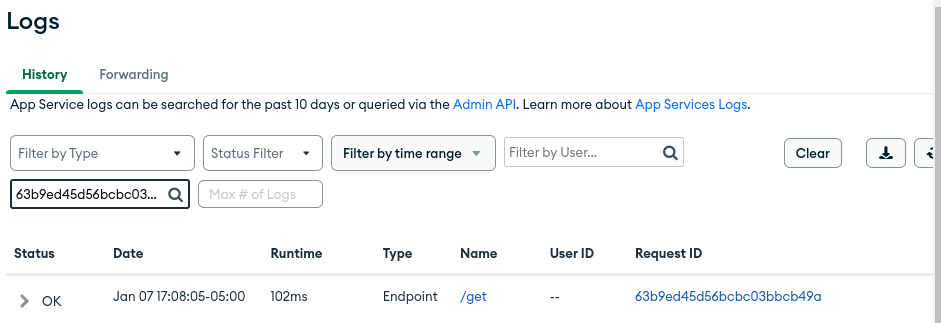

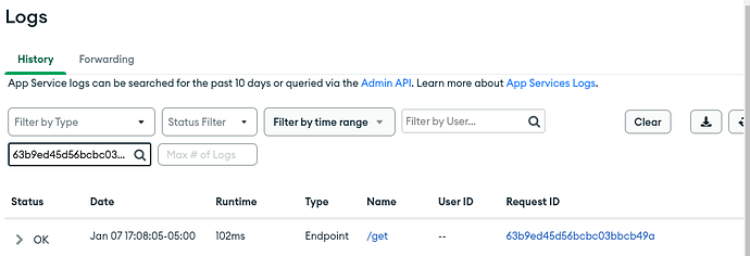

This is what I’m getting from the app logs, even after clicking on the “Request ID”:
I.e., I’m not able to see anything than the end point and the “Request ID”.
Would you explain a bit more on how to see the context.request.httpReferrer in the app logs pls? thx
Oh, by downloading it?
You can expand that log entry by clicking the arrow and it should show your console log.
