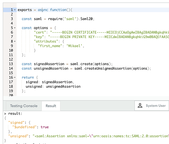

Well @Gabriele_Cimato, it’s the signing part that doesn’t work with saml
package. I would be happy if this one can be supported!

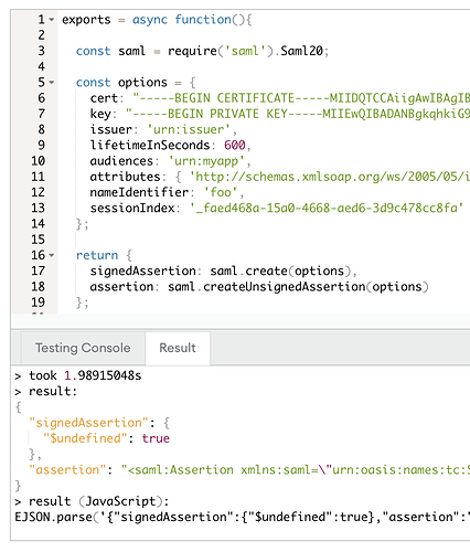

Simple example:

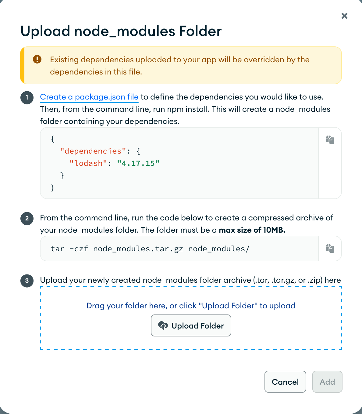

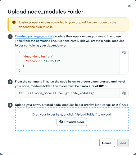

I looked into this and it seems like something is being corrupted during transpilation. If you try to upload a compressed archive like so:
instead of installing the dependency I noticed that it works as expected. Give it a try to see if you can get unblocked while I keep investigating. I hope this helps!
Not really.

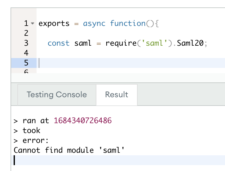

I uploaded a node_modules
archive and dependencies was installed. However, trying to use the library yields “Cannot found module saml”. It looks to be installed but isn’t.
More in next reply…

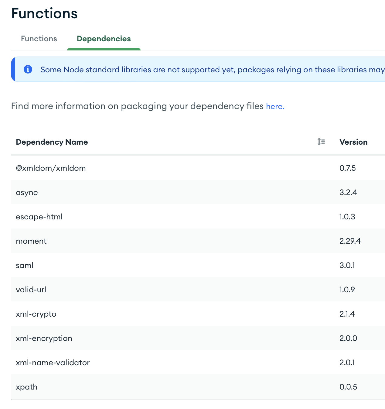

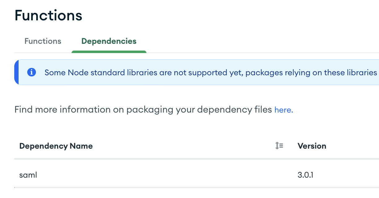

Now, installing library as intended, it looks like this. Same 3.0.1
version. The library is available and usable. Except for the signed part… Try for yourself, I’m adding the code below.
exports = async function(){
const saml = require('saml').Saml20;
const options = {
cert: "-----BEGIN CERTIFICATE-----MIIDQTCCAiigAwIBAgIBADANBgkqhkiG9w0BAQ0FADA6MQswCQYDVQQGEwJ1czELMAkGA1UECAwCQ0ExDjAMBgNVBAoMBU1vbmdvMQ4wDAYDVQQDDAVyZWFsbTAeFw0yMzA1MTcxNjMyMzhaFw0yNDA1MTYxNjMyMzhaMDoxCzAJBgNVBAYTAnVzMQswCQYDVQQIDAJDQTEOMAwGA1UECgwFTW9uZ28xDjAMBgNVBAMMBXJlYWxtMIIBIzANBgkqhkiG9w0BAQEFAAOCARAAMIIBCwKCAQIA36ruOTlsZvICTs9ve0Wc0fUe32wxrFTcrd+Y7ykMgSF2Ykyl+PYFgHUF6WkgdEeXQ23PfCNa+kGQvXM7wY9bQqWUa0Aiac07iArU7XZQYiOFmbcUWSPaGiOeTRvFKRR86ecnA/Faog880KzAYRf5g4E99RVeii0FtQwoYhO4VawoPtAMb2UEZZq/ByUX6zguGsBAQhFBi6I8ifK47I5kLbsYosQNJrhiTSEyb6nHW//k7N7C8NlmHLfzz+2bRmq+zh29FznrwPN/i/pGVnKhElm2R/wvaR+YhpUzyfNX/5M7HgH8mlCNfFMFeh9kbhCUc745nsauhkSkJNVqsppqLoUCAwEAAaNQME4wHQYDVR0OBBYEFDW1+Br2+ROw7Fr1e1W6kv8KrW58MB8GA1UdIwQYMBaAFDW1+Br2+ROw7Fr1e1W6kv8KrW58MAwGA1UdEwQFMAMBAf8wDQYJKoZIhvcNAQENBQADggECAEokh67pGDITXtx0f6H9D22LGNqqGsjHt+DHWk9Kjf7AY7i7qZ1yN5TyWRsrspWsJOfrTh/dOne1aHyHcLPPoY2aRzKaF7h0SV9QbjjURHKn4GlY7Xks3xQ4VxsxBTszUN8aqqLRuPcH3ulEeq6AqGRPO0fYLmtlAJ0DFKxalw5SIZXjwlo3Vqui/ufiPlk+0cqKcS8YRRPX5wmcr9BJRSGyaGy0Zw92LyX0IUeP6qi2wT9GirF0gUrbEY+TfARYUy3eDHVdSV3S5foEcRaA0WbPxplC90Cd5JEo64YkdxS0wasQHV+YeRiF6yk6Bms6aRiBTqWYZ5hA6KGZCqYPGw6j-----END CERTIFICATE-----",
key: "-----BEGIN PRIVATE KEY-----MIIEwQIBADANBgkqhkiG9w0BAQEFAASCBKswggSnAgEAAoIBAgDfqu45OWxm8gJOz297RZzR9R7fbDGsVNyt35jvKQyBIXZiTKX49gWAdQXpaSB0R5dDbc98I1r6QZC9czvBj1tCpZRrQCJpzTuICtTtdlBiI4WZtxRZI9oaI55NG8UpFHzp5ycD8VqiDzzQrMBhF/mDgT31FV6KLQW1DChiE7hVrCg+0AxvZQRlmr8HJRfrOC4awEBCEUGLojyJ8rjsjmQtuxiixA0muGJNITJvqcdb/+Ts3sLw2WYct/PP7ZtGar7OHb0XOevA83+L+kZWcqESWbZH/C9pH5iGlTPJ81f/kzseAfyaUI18UwV6H2RuEJRzvjmexq6GRKQk1WqymmouhQIDAQABAoIBAUPK81m05f5t6/UnOosKlnWs7iaaDJRHRHwPAbO7pWaeVduFj+jd6Nz+m0Qb8RJNgLOXXQQrUy/3H3/MpZgNc4PH3CyFy+h1pE2futoeuk6EpcHpk+lQzJKPqTOF70R8SUA8J78yMF5eb/hv4/+J3L7XNYhLadRHwSsW/EZ946lT8+sAyZaR5BKBN/NXKHvttGEpDUJfJ8bBsAEmTOH3B2C+ILjdh7nTPgcms/yOmD1TixoOBdGJ38DNgaEwi+x1qb87RyHbcCbtJ8IJRsZgD7GrVZqo7KIAyk4DHDmCrl4vzXokw5a7CnWGTMf0jlwmz5joWn7Jc55qXp0Wuw6kMW8hAoGBD7mfgexvYFdJmNseipsw6888LT+Tmf+H/xcThC/HYVQQaGP+JwyYdIb6zIIYloJYxVTBC8odmvAJy3V+qKfyJfUqweqzssPXY9M+1K4/+LQrxlBc5RFhXGCVqO+PevjitFDnPFXe+leOnj8L1eYtLXDSsSNAnAGqlRmS32LN8HYbAoGBDjk/H0tyQYmpKnGG93eKFxw5wjzKBlL3M54X1Xf1Y6pFu841jLjCUJ37kh3JAoHdc8Fx8140tu6mFZsMusbdwyivQ8tEUKvmnaOvrhQo41HErjbx/JEZu7MtSlr4o8s5S2PPNQktnacTwuj9njFsRbagOblvxYDQHzziwurE8rffAoGBDDuzwzdUTfaZ4rhUQjAJFunZPro+8YbBHcmt/R/OVAE54nwns+kwkTaQ1Zg/2Jb+yETvCWTrMyWZ+RYmur4suyrHYKRdt6xzW81zC7GjQq+nflf2bJ3gyCS7SPlU/a2xb+WgfmevV8HVyXXylyzB6J/kyLlMAhGpyuRiRjZvT6oRAoGBC8VOOny6OghNKWW39rVDXuqp1ddurJseHeZX/P1/4pG3kbsNz73aeNK0rO/fOCb2d+P/hBJS94w5f6nHeA442Vei6yydBVGs0In0SdA/Ihe59x5bVdNSg2W9Nkpgd1Qnvv8DK/XDfTMWBHfB4pct7ec7Y2nVWJHIKgG9+uZERETrAoGBDuWOSauuHAXMW77e/4HMLrVMP7IuaXjWqudp2SRtQ49FIhgcnltU9f8e1OPQSD5fQrAOKjH34u39vpuMn6mI/wsWI44X234e9DcVIkmD4+pgtMRP7fk9IEUh9uM0h91FJ3+y9sp/5JZnqNqdHFlPYnsW1ePCE/f94tF3wK8dlFo/-----END PRIVATE KEY-----",
issuer: 'urn:issuer',
lifetimeInSeconds: 600,
audiences: 'urn:myapp',
attributes: { 'http://schemas.xmlsoap.org/ws/2005/05/identity/claims/emailaddress': 'foo@bar.com', 'http://schemas.xmlsoap.org/ws/2005/05/identity/claims/name': 'Foo Bar' },
nameIdentifier: 'foo',
sessionIndex: '_faed468a-15a0-4668-aed6-3d9c478cc8fa'
return {
signedAssertion: saml.create(options),
assertion: saml.createUnsignedAssertion(options)

@Mikael_Gurenius I just deployed a fix, would you mind giving it another try? No need to upload dependencies you should be able to do it by adding “SAML” through the UI. Just to be safe try it with a new app and let me know!
@Gabriele_Cimato, thank you! I can confirm that the code snippet I posted above is now working!

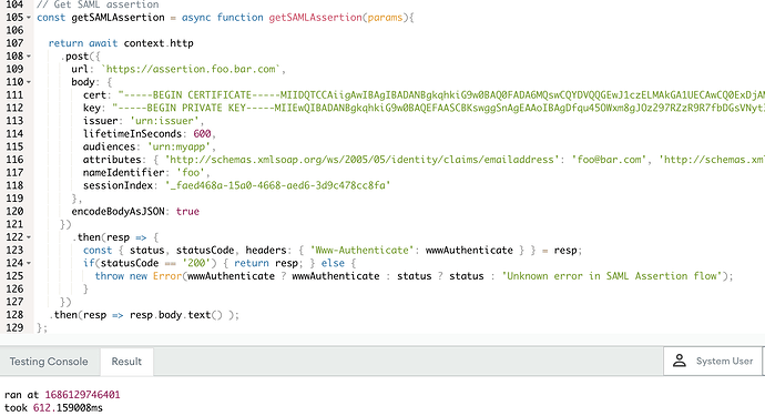

…but is awfully slow.
Testing a few times is 1.5 - 2.0 seconds for the execution. Whereby my current implementation is stable in the 0.5 - 0.7 region doing an external HTTP call to a node server with one task: return the signedAssertion.
