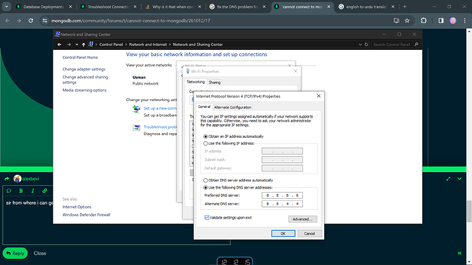

how can i connect through latest version too, i have fix the DNS problem too like 8.8.8.8 and the other one 8.8.4.4 in adapter settings in ipv4 properties but it was not the issue in my case
