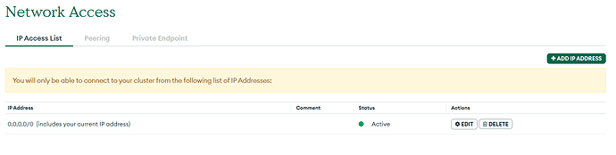

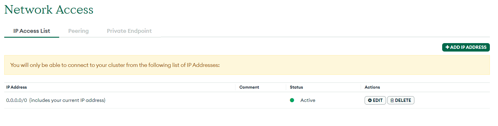

  3. I have created a user and a database just like the tutorial. I have added a snapshot to show the whitelisted IP in Network Access.
Note that I am using windows 11.
