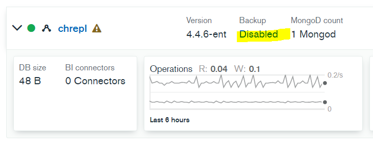

I installed and configured Ops Manager to test functionality. But I could not enable backup function on replicaset MongoDB Ent
Please help me how to enable it?

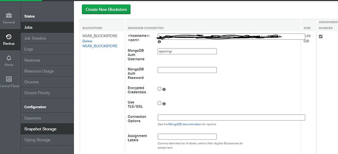

Yes. agent up and running
but I could not enable the backup function according to the manual

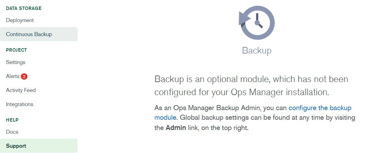

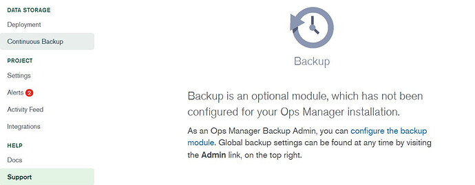

One of your earlier screenshots indicated that the optional Backup module was not configured for your installation, so did you end up completing that configuration?
Stennie
Hi
Sorry that I did not reply for a while.
Yes, my module was not fully configured. It turns out that I did not complete the Oplog Storage setup.
after completing the configuration, the backup function worked
