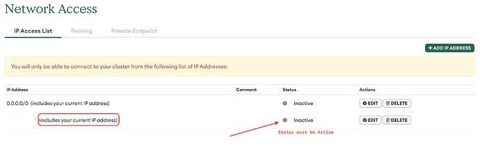

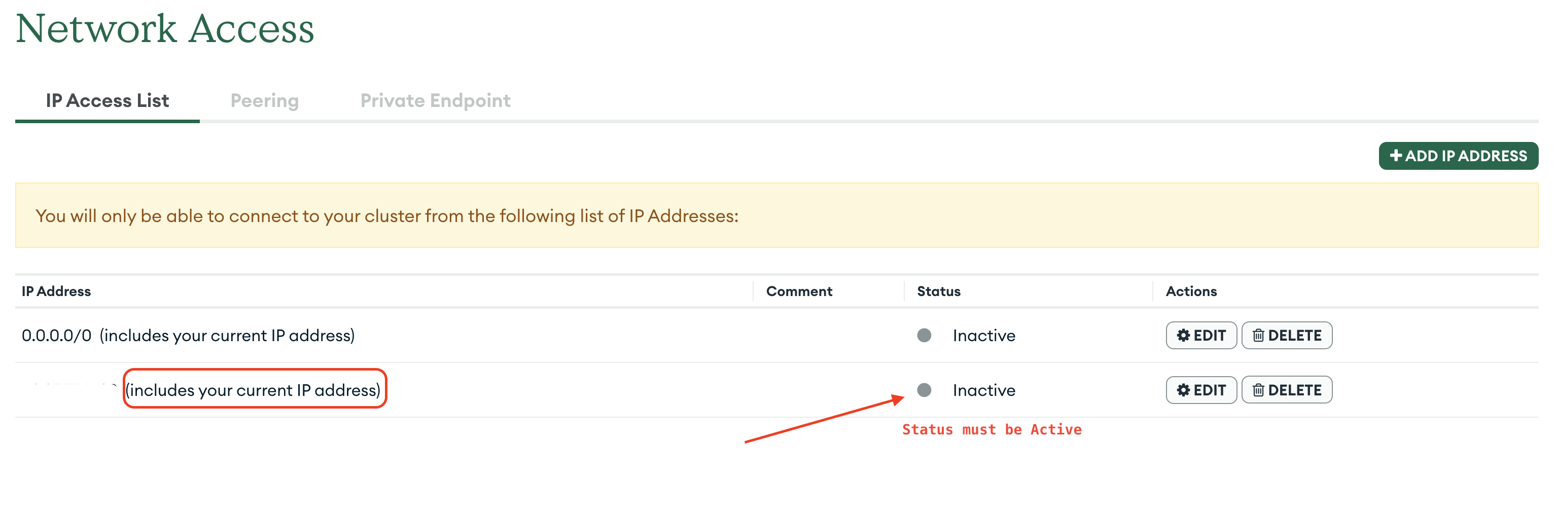

Can you please confirm the following:
- Is the client attempting to connect the machine associated with the public IP address you added or is it running in a VM on the said machine?
- Are you able to connect properly when “Allow Access From All IP Addresses” /
0.0.0.0/0 is added to your Network Access List.
Also, can you verify that your current IP address is whitelisted (includes your current IP address) in the MongoDB Atlas Dashboard?
