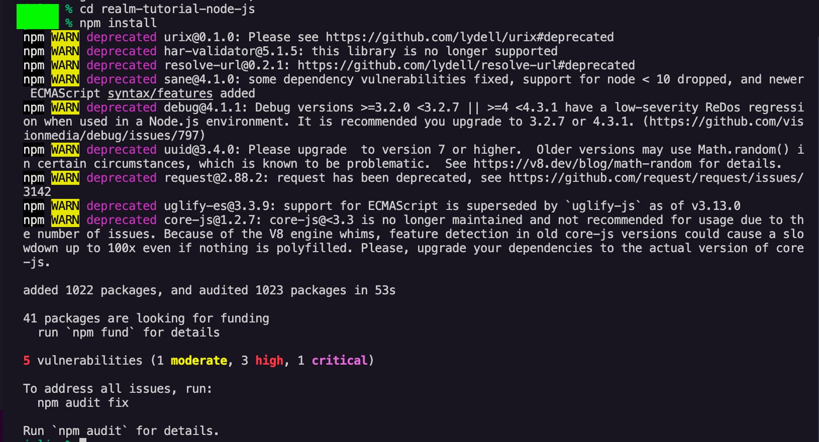

I’m following this Task Tracker tutorial for Node.js and am currently at step A.
When running npm install, there are warnings about deprecated dependencies that look like this tutorial is using some very old version.
Just curious and want to ask what are the best ways to deal with these warnings in most situations?

Usually, you can fix these by running following command:
npm audit fix

npm audit fix should fix all vulnerabilities without breaking changes.
It can happen that some vulnerabilities will not be fixed because they include breaking change. These can be fixed by running npm audit fix --force. However, before doing it you should check the docs for relevant packages because breaking changes can break your app.
