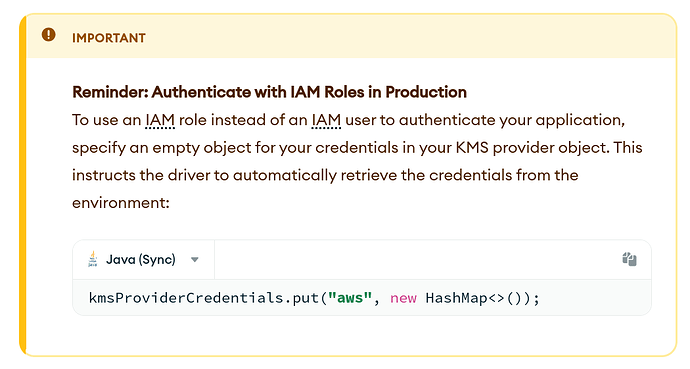

The AWS KMS config is supposed to be done in the code when you create the kmsProviders.
Check this doc:
There is also this note in the doc that is your solution I think:

I figured out what I was doing wrong. I was thinking that kmsProvider also holds master key details like ARN and AWS Region. However KMS provider only tells which kms system to use and key details we need to send separately to mongo client. Below is code snippet which worked for me.
MongoClientSettings mcs = MongoClientSettings.builder()
                .applyConnectionString(new ConnectionString(CONNECTION_STR))
                .build();
        ClientEncryptionSettings ces = ClientEncryptionSettings.builder()
                .keyVaultMongoClientSettings(mcs)
                .keyVaultNamespace(KEY_VAULT_NS.getFullName())
                .kmsProviders(new HashMap<>() {{
            put("aws", new HashMap<>());
                .build();
        ClientEncryption clientEncryption = ClientEncryptions.create(ces);
