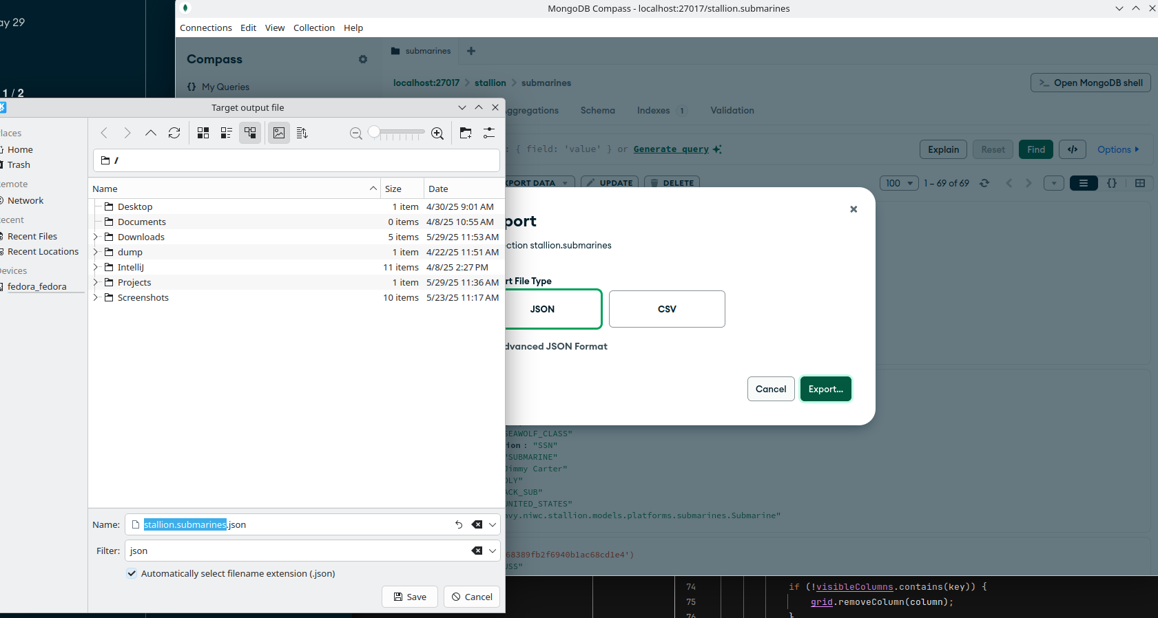

I want to export a collection. The process seems simple: Export Data → Export the full collection → Export → Save. Yet, after clicking Save, nothing happens… not errors, no progress bar, nothing. And, of course, nothing is saved. The Target output file UI sees other .json files in the target directory. This should be a simple procedure.

And I click “Export …” and up pops a file requester for the filename.

The file requestor which I assume is the Target output file dialog box has a Save button in the lower right corner. When I click the Save button, the dialog box closes, but nothing else happens. I know no files get saved because I ran a find command. And I’ve tried a half dozen different file paths.

Does selecting the home folder in the file save dialog before saving fix the issue? That would give us a check of if it is the issue from the investigation below is it. (Also it would serve as a workaround for now).
Doing some investigation:
This may be the same file pathing issue filed in signal’s desktop app: Unable to save media or files via Desktop on Linux, while Android works fine · Issue #6912 · signalapp/Signal-Desktop · GitHub
They fixed in Fix file save dialog default path for Linux KDE · signalapp/Signal-Desktop@520620f · GitHub
Seeing mentions of a KDE Portal xdg-desktop-portal-kde issue happening which may be the root cause of the bug. [Bug]: GNU/Linux/Fedora/KDE: file selection dialog doesn't work · Issue #42250 · electron/electron · GitHub
Which means our file selector returns nothing so we just are closing the file selection.
As a fix we can try explicitly adding the home path for these environments, similar to the signal fix.

clicking Home before navigating to the desired folder indeed could be used as a workaround!
