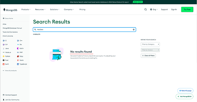

Search on the site yields no results at all.

I have checked links and have not found documentation for the “HexData” function.
