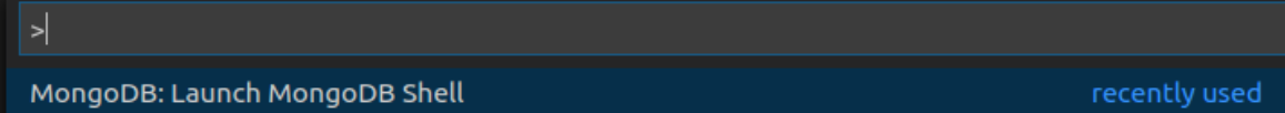

- in VS Code press F1 and get the “command filter”
- Select and run the command
MongoDB: Launch MongoDB Shell

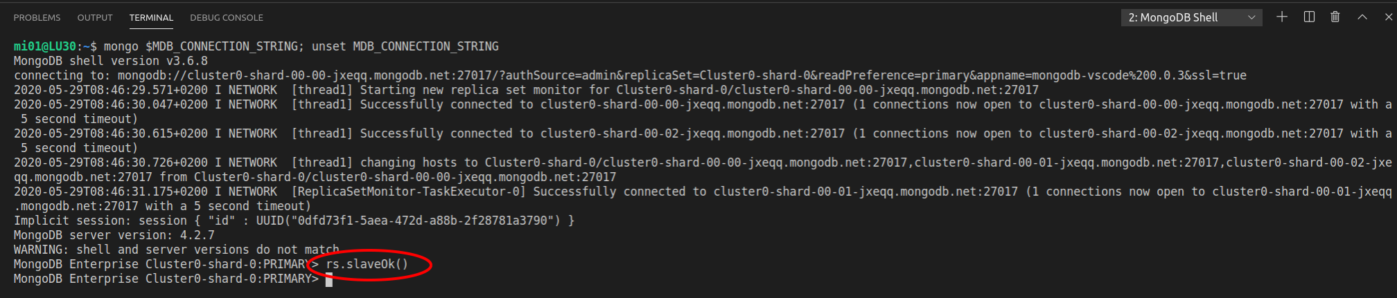

- flip to the shell window which opened at the bottom
- run the comand
rs.slaveOk() in the shell this will allow reads from Secondaries
This should fix the error message you have posted.
