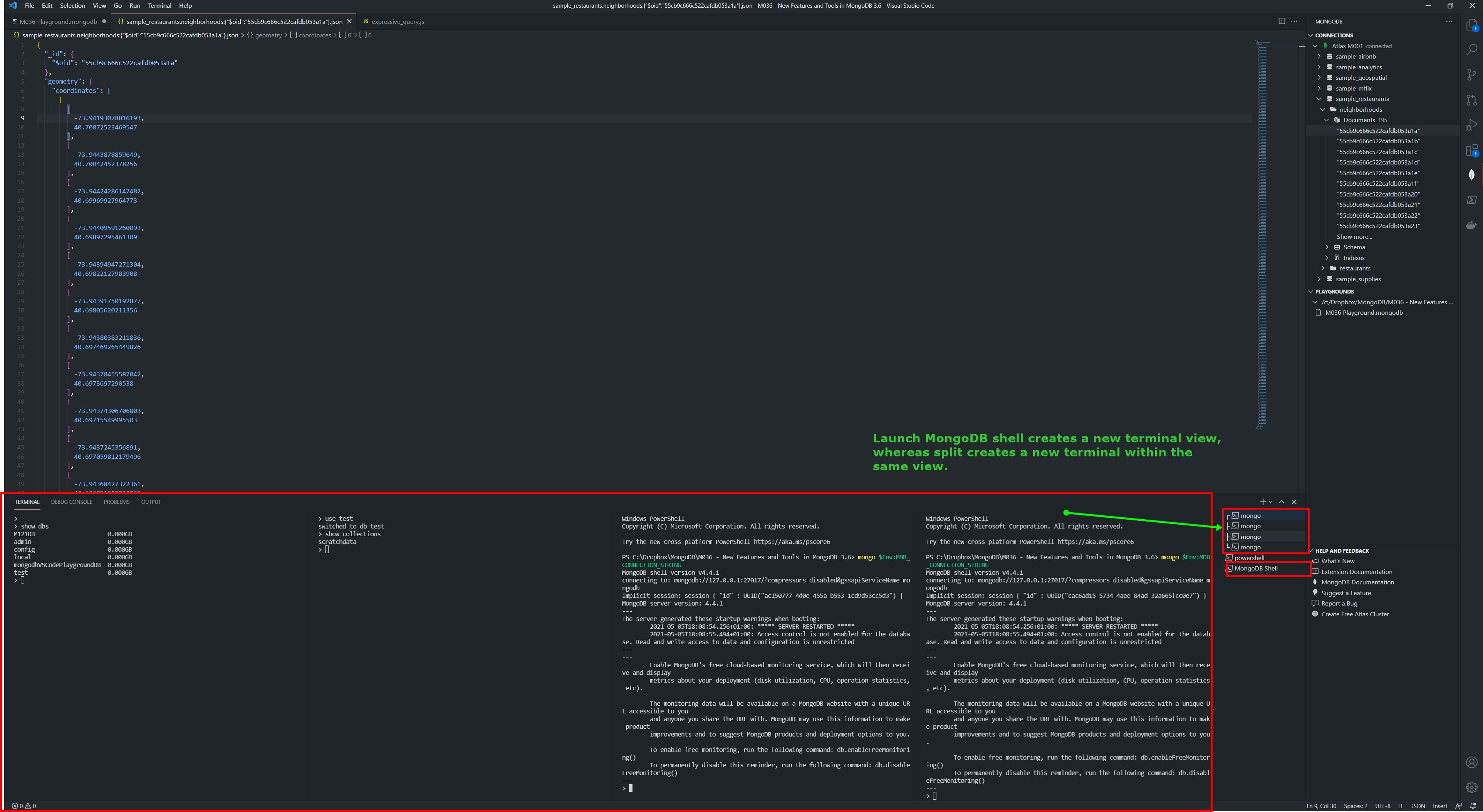

The issue with the Launch new shell, is that it creates a new shell completely, not a split. I ideally donât want to be going back and forth between integrated terminal views.
The reason why.
Sometimes I will want to look at data, while on another terminal session refine a query, or I want to check that the playground has given me the correct results, which it doesnât always. Sometimes comes back with [ ] btw.
If I have the mongodb connections tab open, then I lose a right side (CTRL-B), and at the moment the schema analyze view in connections, isnât as good as the compass one.
If I am at a terminal level, then I can spawn multiple terminal sessions quickly all nicely spaced. Looking at data via the connections tab (So not always a good space trade off), and fills up the screen with tabs. See screen shot.
I suppose itâs all about having options on how to work (The view below is on a 42" monitor so itâs a lot more readable than it seems).
