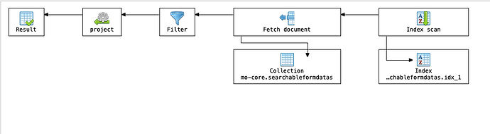

However, the query plan shows that it’s still fetching data and not using the covered index.

The textual explain plan will be much better for us to help you than the nice graphic you posted.
