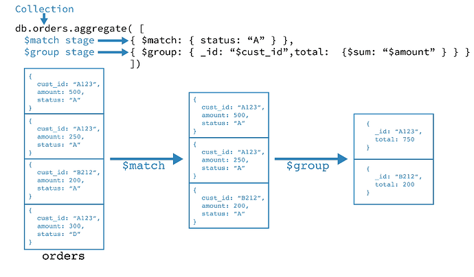

it will look somewhat like shown in the screenshot. You should see the results of every stage on the right side when the stage definition fits

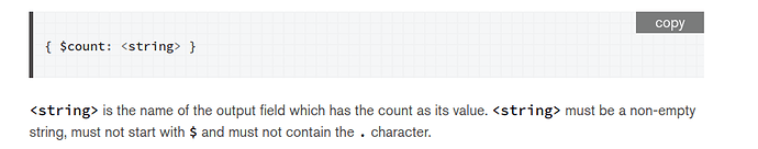

The string with the $count is just the filed name. Here is the link to the documentation were I too the screenshot: $count

you do not need to, the result of one stage is passed to the next stage on which a further stage can act, you can look on it as a filter which narrows down with every stage.
