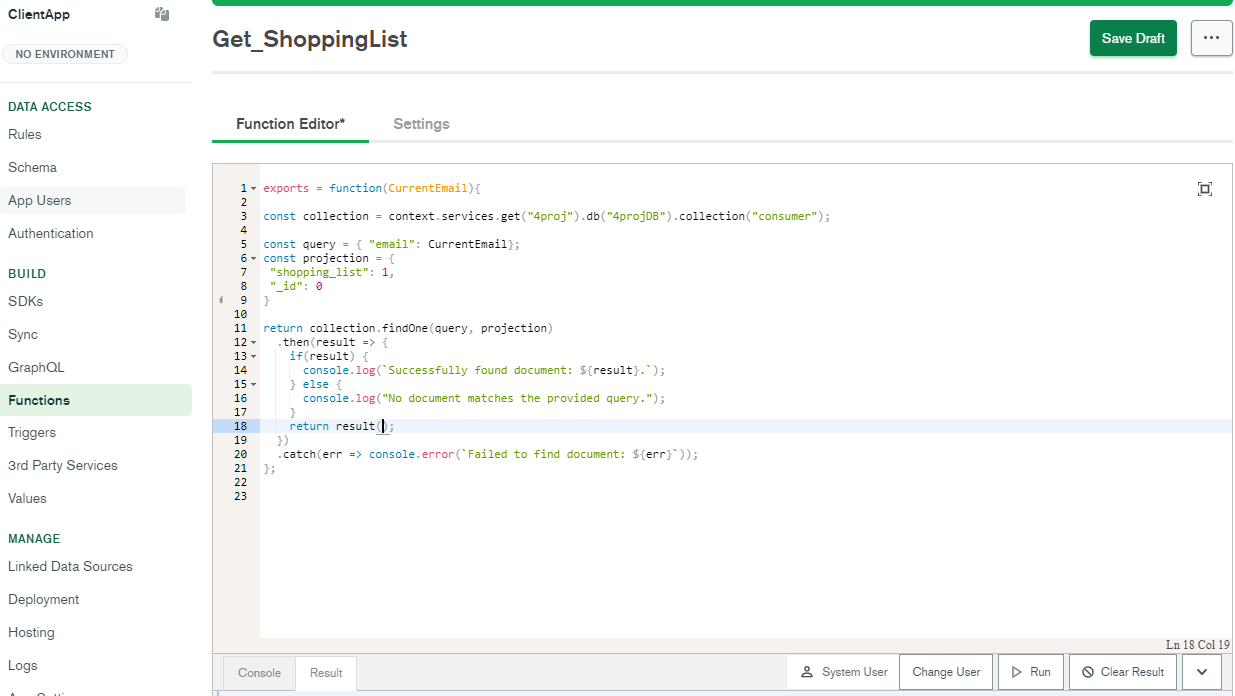

I would like to use a function from realm web site.
An example :
I guess pull function doesn’t exist cause I didn’t find it.
Is it exact ?
