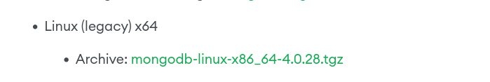

The Linux tarball installation may work on Ubuntu 22.04 this ran in a very basic configuration on a ubuntu 22.04 contianer.
Using the tarball or containers will allow the progression along the upgrade path until 6.0 where Ubuntu 22.04 is supported.
Thanks, yes, I ended up finding this and using it. I’m going to use that to upgrade all the way to 8.0 and then switch to Ubuntu 24.04 and use the deb repo from there on. Thanks Chris.
