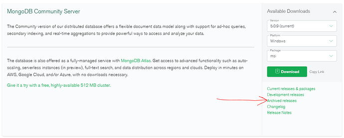

I went here to try to find the archives:
It leads to this link:
https://www.mongodb.com/download-center/community/releases/archive
