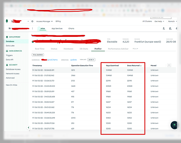

Hello,
It seems the doc does not refer to that particular return of the UpdateMany with aggregation pipeline
here => https://www.mongodb.com/docs/manual/reference/method/db.collection.updateMany
and here => https://www.mongodb.com/docs/manual/tutorial/update-documents-with-aggregation-pipeline
Do you think it’s possible to say to MongoDB to not return all documents from the aggregation pipeline? I have some stupid amount of documents returned and I’m a bit concerned about the next few months of my application. I’m afraid of blowing up my atlas server.

all requetes from mongodb atlas

@huneau_romain, the screenshot you are looking at is the Atlas UIs Profiler TAB. And, the update query shows the query filter and the update. The planSummary
is the query plan details.
This detail tell how many documents are matched and are updated/modified.

Yes, I agree with you but the profiler told us that 104968
key was examined and 104968
docs were returned.
I’m concerned about docs returned that have to be 0
I’m just figured it out that nreturned
field is not present inside the MongoDB explain thing.
This morning I launched the query ant I got the 104968
result. Now I relaunched it and I got nothing
@huneau_romain here is the link to Query Plan output examples. You can see various fields in the output and their meaning. Hope it clarifies some things.
