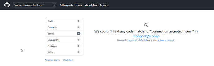

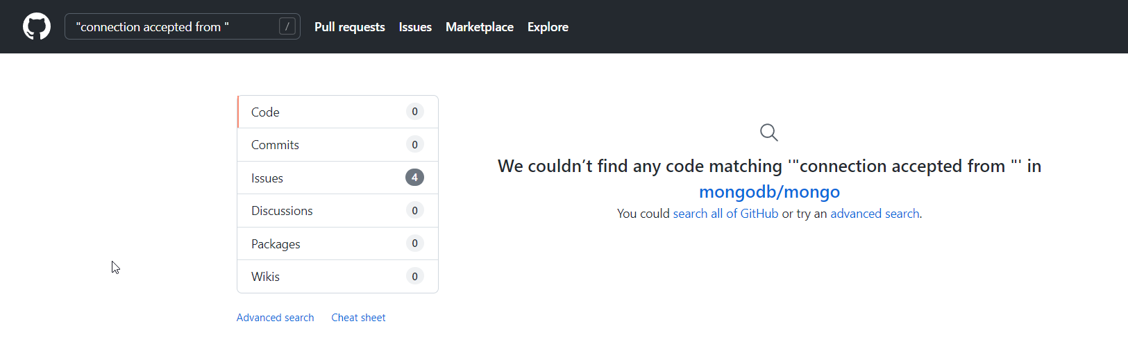

The first thing I tried was searching for the string "connection accepted from " using the github searcher on the mongo repository but I didn’t found anything. Maybe I’m using it wrong.
