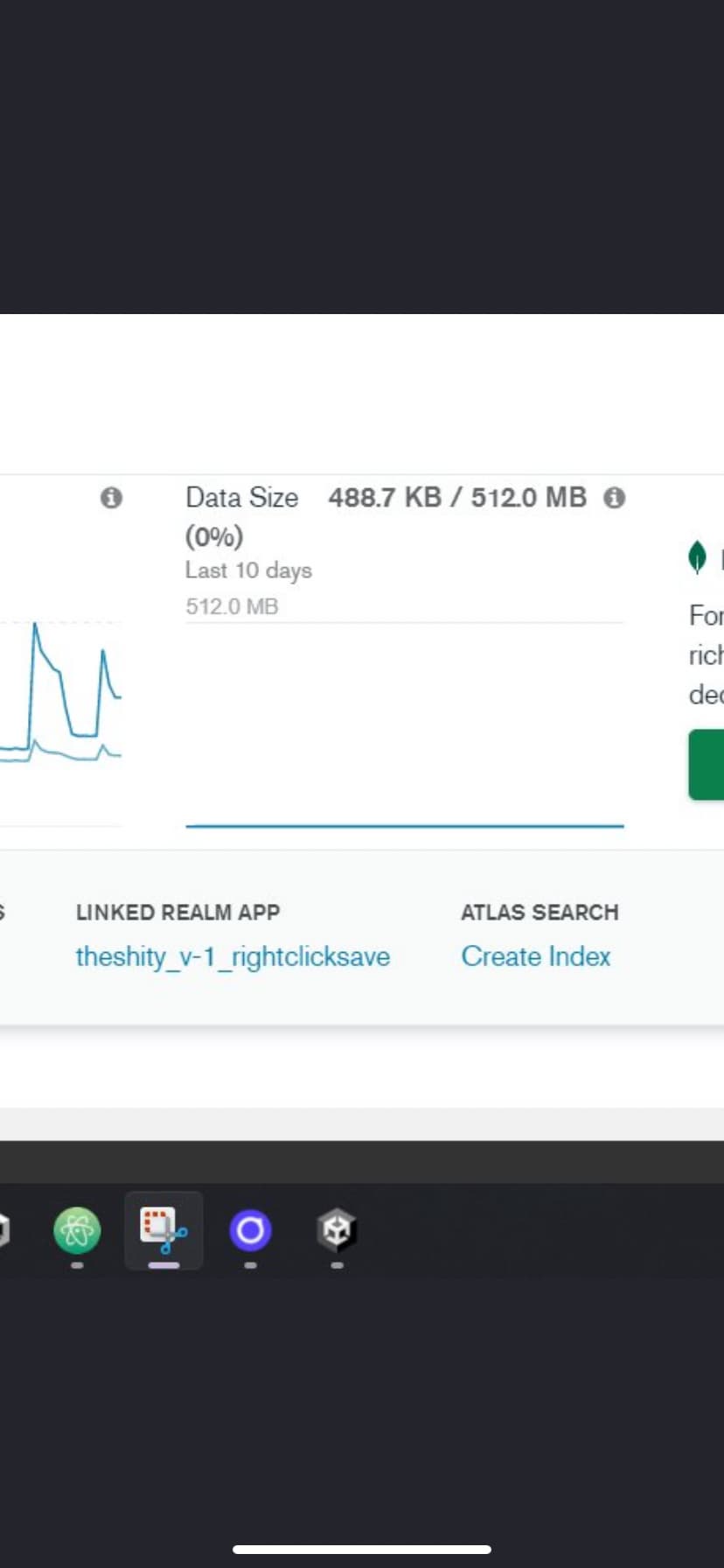

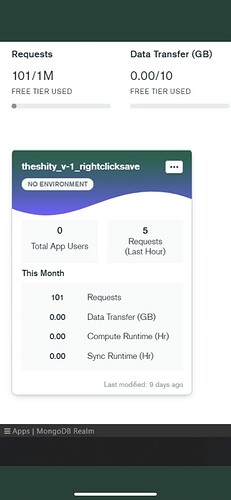

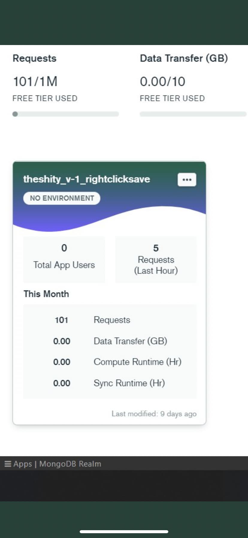

Just to confirm, when you say it is not posting to the database, are you saying it is not appearing in MongoDB Atlas or it is not appearing in your local Realm database?
I can’t find it in any of my atlas collections on the MongoDB browser UI or Compass. Metrics measure 0 data transfer on both Atlas
And realms

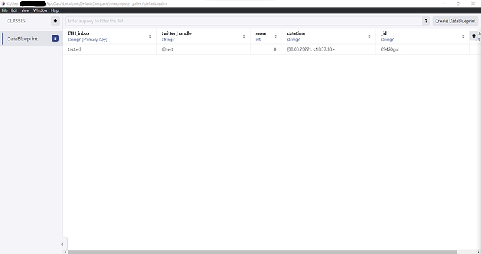

Hi @Anon123,
Can you please download Realm Studio:
https://studio-releases.realm.io/
With Realm Studio, open the local Realm database for your game. Let’s ignore the MongoDB Cloud for now.
I don’t have the exact answer on where the local Realm database would be stored on your computer, but for me, my database is stored here:
/Users/nicolas.raboy/Library/Application Support/MongoDB/Mongo World/mongodb-realm/mongo_world_demo-ebxbj/61928794a3efdfc437002536
You’re looking for a .realm file and it can be opened with Realm Studio. We basically want to see if data is even making it into your local Realm database. If it isn’t making it into your local Realm database, it isn’t going to make it into your remote collections.
Need to pinpoint the failure spot and go from there.
Hopefully that makes sense.
Best,

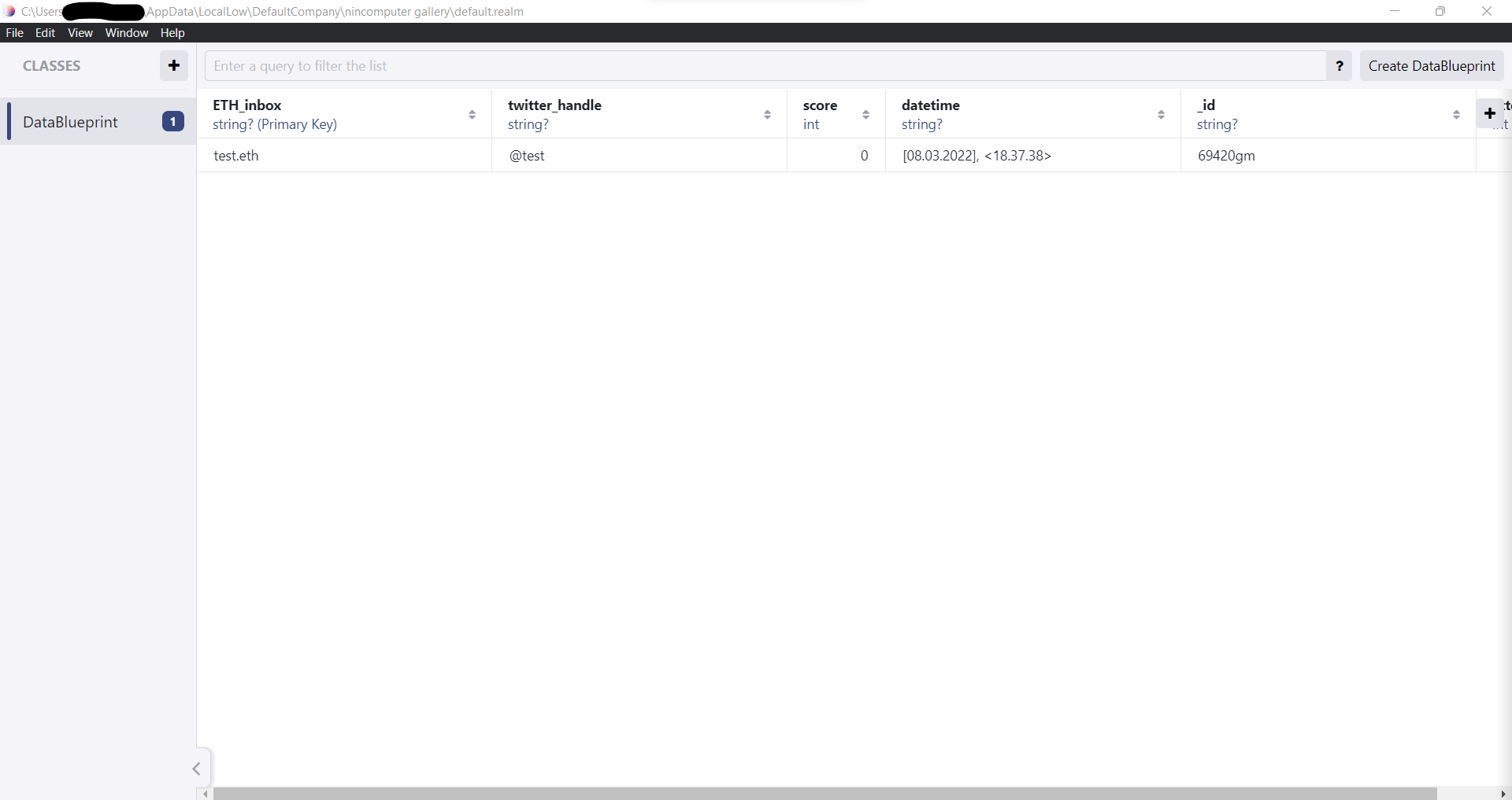

Is this it? Old realm document from 3 days ago, before I even asked for help. I can’t find any other realm documents, so have my new changes somehow (for lack of a better term) broke the code?

Hey @Anon123,
The path looks like it is probably correct. Only you would know if the data looks right :-).
If the data is just test data, try removing the parent directory to the .realm file or the DefaultCompany directory. This will allow your Unity application to create and start with a fresh database next time it runs. While not at all common, something could have gotten botched at some point during development.
