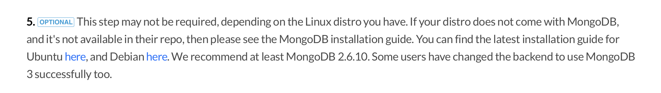

In the process of upgrading my Unifi Cloud Controller, a step included a suggeted install of Mongodb. This install process has lead me down too many rabit trails and now i can’t even uninstall.
after following the community edition installation guide, reaching a point of major frustration, i now exist in a perpetual cycle of this:
