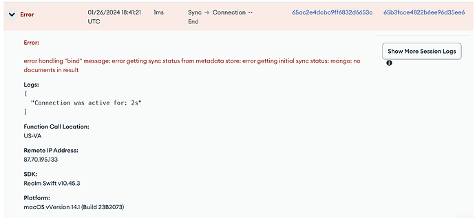

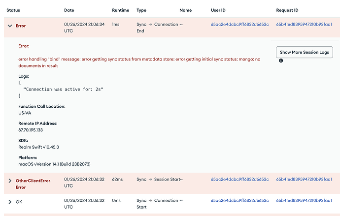

When looking in the Atlas console I’m seeing the following error:
error handling “bind” message: error getting sync status from metadata store: error getting initial sync status: mongo: no documents in result
