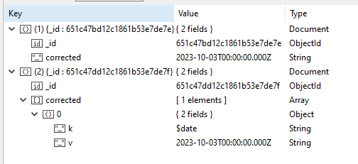

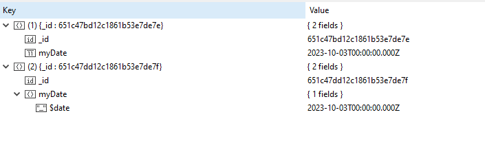

The only other think I can think of is it the data was somehow stored by the ORM with an actual $date as a field name as opposed to an actual date, in which case it could look like a date when it was not.
I crafted this:
The first document has an actual date, and the second, I created using $date as a field name, if I export using mongoexport it looks like this:
I wonder if this is what happened?
db.getCollection("Test").aggregate([
    $match: {
      $expr: {
        $eq: [
            $type: "$updated_at"
          "object"
    $project:{
        corrected:{
            $cond:{
                if:{$eq:['date', {$type:'$updated_at'}]},
                then:{$toString:'$updated_at'},
                else:{$objectToArray:'$updated_at'}
What does this show? With my funky data I get this as the output:
