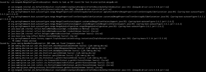

I have a single node GCP cluster with my spring-boot app running. I recently created a new DB [M10] cloud atlas and trying to connect it via my app. However, I keep getting the following error - screenshot attached
However, I am able to connect to my old DBs [M20 and M10] via the same GCP cluster and same spring-boot app.
I am unable to figure out what could be the reason? Any idea?

Is there a final “Caused by” that’s cut off from that screen shot? That could help diagnose the issue. It’s possible that you’re running into https://jira.mongodb.org/browse/JAVA-4018, in which case updating the Java driver to 4.5.1 or later will fix it.

final caused by :

You can see from the stack trace that it’s using mongodb-driver-core-4.4.0.jar.

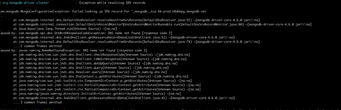

Thanks for spotting that. But after upgrading I am still getting DNS issues
It is not the same address as before.

There’s something wrong with the new Atlas DB instances. There seems to be an issue only while connecting with the new DB. The old DB connection are working perfectly fine
Notice that now the TXT record is no longer failing (that happens first) but SRV lookup is still failing. Using dig, I’m able to resolve both TXT and SRV records for this host:

Can you try the same from the same server on which you’re running the Java application?
looks like dig worked.
then maybe some issue with com.mongodb.internal.dns.DefaultDnsResolver ?
I think it is something in your environment. I am able to connect successfully to your cluster from both the mongo shell and a Java application.
If the issue was with the environment wouldn’t there be an issue connecting to other Atlas DB? [as mentioned previously, I am able to connect to the other 2 DB via the same GCP server, same application]
Not necessarily, but I don’t have a hypothesis that explains what both of us are seeing. I think at this point you should open a support ticket (https://www.mongodb.com/docs/manual/support/) to try to get to the root cause.
